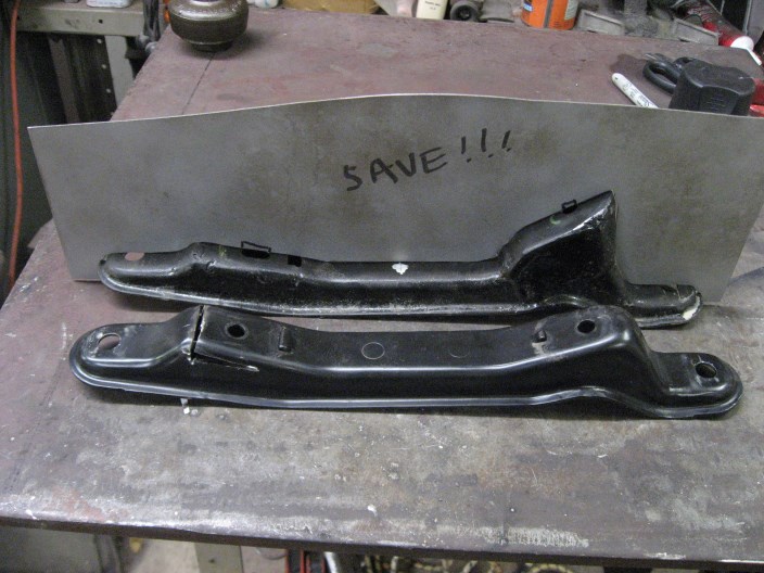

                When you get to the transmission mount, you should cut the low side so that the mount isn't twisted at an angle.
                Cut a pie shaped section from the sides of the mount and flatten the top down. Then weld it back to solid. Also flatten the little ridge on top if the mount gets in the way of it. We weld that hole up too but only to make the support look more "finished". It doesn't improve the strength or anything.
                I take out .250 on each side as you can see in the photo.

                  lol, just because it's bigger doesnt mean that it is going to be at the right angle.
                  dougsic makes some sick shit, I recommend his work.
                  It put my fabricating skillz to shame.

                    so basically i can take my air grinder to the passenger side of the mount and slice it?
                    the space you see on the subframe is spacers. maybe they should go on the top of the mount, or mabe i should use them at all.
