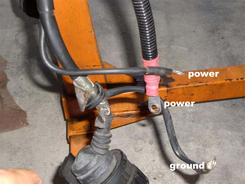

        well, an awesome update. My motor is all put together!
        Anyone know what this connector goes to?
        Does this hose go to the chorcoal cannister?
        curious about these wires in the last 2 pics.

                        #101
                        wiring
                        • BDSax
                          Junkyard King
                          • Mar 2006
                          • 3594
                          #102
                          sweet, how about the other 2 pics?
                          • FredK
                            • 14761
                            #103
                            Pull back the rubber boot and see what colors the wires are. No two connectors have the same wire colors.
                            The 2nd to last pic, that just goes to the large lug on the starter. You should use the E30 power cable though. It has the proper termination for the E30 power cable on the passenger side of the car. Otherwise you'll have to crimp a large power connector onto the E36 power cable.
