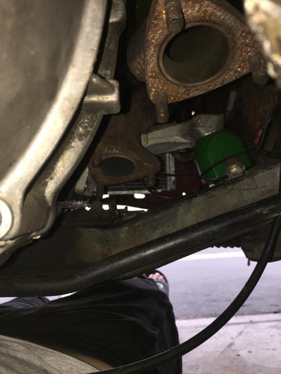

                        I have S50 and I'd like to know what engine mounts are you guys using? I am using the revshift mounts and the bank 1 (cyl 1-3) exhaust manifold gets too close to the subframe and nothing can be done. Tried M52 exhaust manifold and same issue. I have OBD1 downpipes ready but it won't attach due to the very tight space..
                        • mjweimer
                          • Dec 2015
                          • 648
                          I have heard of folks that notch the subframe to allow for clearance of the E36 downpipes. Not easily done with the subframe in the car.
                          Others have sourced extra E36 flanges (cut from a center section) and re-welded them to a section of properly bent new pipe back to either a custom cat set-up or a cut E36 center section.
                          I plan to try and notch my subframe but would really like to see some pics to get a better idea of what area needs clearanced.
                          MJ
                          • ykarabala
                            • Oct 2014
                            • 90
                            Thanks, for the input. I ordered a set of e28 M5 engine mounts since that's what people typically use and I'm gonna see if that'll allow me to retain the stock headers. Took my car as is to an exhaust shop and they wouldn't touch the cast iron...
                            • jayuuey
                              • 414
                              You leave the cast manifold alone and modify the mid-pipe piping for the front bank only. I just got mine done for CA BAR and tried doing minimal mods to the exhaust. I have 2 inch ground clearance with my setup. Its pretty bad.
