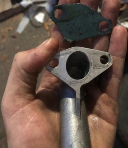

                Well, I removed the oil pan, nut still on there. A few days later went to check on things and I looked at the oil pickup tube again, then I looked at the gasket and yup, that has to be my problem! Oil wasn't getting through that hole!
                A member mentioned oil squirters. Will be removing crank tomorrow to verify they are in there but I doubt it. A friend has a blown M52 that he's willing to give. me. Will crank/rod bearings and oil squirters fit in my s50?
                Thank you all for your help!

                  WTF is that gasket! After that I would suspect that nothing in that engine is correctly done.

                      Lol I understand, but it was what I received when I purchased the oil pickup tube and dipstick from an individual and forgot to modify it. For peace of mind, I want to check the bottom end and need to know if the m52 bearings and oil squirters will work?
