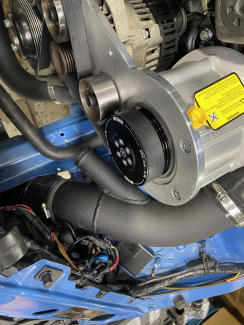

                I have an s52 with s54 oil filter housing. I'm losing belts, has anyone had that happen & if so what was the solution?
                [IMG]https://cimg4.ibsrv.net/gimg/my350z.com-vbulletin/550x225/80-parkerbsig_5096690e71d912ec1addc4a84e99c374685fc03 8.jpg[/IMG
                  Are you running the deflection pulley off the alternator?
                  @Zakspeed_US
                    Sorry, I did not see your post. I'm not sure what a deflection pulley is, I have an ActiveAutohaus Rotrex C38 SC that has 2 additional pulleys.

                      I found the defelction pulley & ordered one, I have tried a belt size down & 2 up, all come off. I have 4 "OEM" tensioners (URO, Febi etc) they all cannot keep tension (land over 1/4" plus from where they should be & the belts move forward from 1 second of running (largest came off)
                      I ordered a hydraulic for an S/M54 as I am running out of ideas yesterday. I can't believe a freaking belt has kept me from driving it for over 3 weeks.
                      Help me Obi Wan, you're my only hope...
                        The pulleys keep doing this (sitting with insufficient tension)

                          I would be looking at pulley alignment over finding a different tensioner...
                          84 325e - 91 325i - 92 318 touring - 91 Trans Am - 01 S4 avant - 03 S-type R - 96 F350 - 15 SS - 84 Biturbo - 91 Defender
                            I got an S54 power steering pump to fix that as the S54 filter housing has a different mount. I know others have used the S54 filter housing to get the cooler lines for a Zionsville cooler.
                            These tensioners do not offer tension.

                              Solution was the Hydraulic tensioner and belt 2 sizes smaller.
