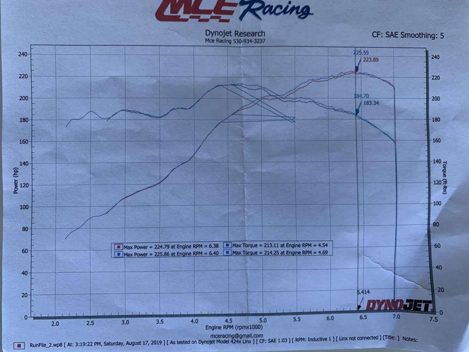

    Nice, post graph?

      Originally posted by ian e30 318is
      Welp I feel like an idiot. Finally dyno’d the car today. Graph was perfectly smooth and pulled strong. The culprit? Bad timing when installing the VANOS. Make sure the engine is TDC via the piston AND NOT the marking on the engine timing cover and the harmonic balancer.
      happy to hear that its sorted!

        No idea what happened to all my pictures and no idea how to embed pictures with the new system.
        Link to graph here: https://www.r3vlimited.com/board/fil...hotoid=9862490
