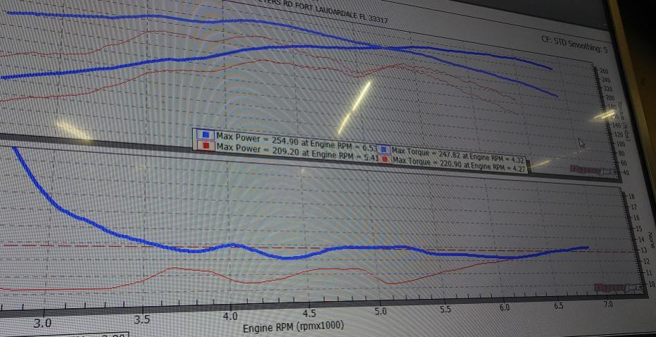

                          Not really. I just built an s50 for a local. I stroked it using an s52 crank and installed .5mm over 11.5: pistons,+1mm valves, dual valve springs, light head work, stock cams and it made 255whp/248wtq with a 7k redline - just doing my basic power tricks and balancing everything. Dyno tuned on the stock 413 red label. Took 2 trips to the rollers since the 17lb s50 injectors ran out at about 5500rpm, installed 21lb and went back...

                            Closer to 10% drive train loss in an e30/e36. Stock e30's do 150whp bone stock fresh engine, 160+ in spec e30 trim (no accy's, .5mm over). I have dyno'd bone stock s52's and they do about 210, had one anomaly that did 219. This put the e30 at about 11% and the e36 at 12% - but without testing between an engine and chassis dynos on the same engine, it's just a guess at best.
                            Either way, trying to calculate BHP from WHP isn't very accurate. The 15% drive train loss is based on typical live axle car with an automatic.
                            Still some nice numbers, also interested in the rest of your specs.

                              So you two are getting bigger torque number per litre by slapping few parts to the engine with tune. Than the best commercial engines that car companies with dozens of engineers and lot of money has come up during the years of engine development. I mean the hp numbers are you have are acheivable with m5x based engines. But max torque per litre in NA engine is limited by laws of nature...
                              As stock m5x based engines make 75ft-lbs per litre. And the best tuned ones 82-83 ft-lbs from crank.
