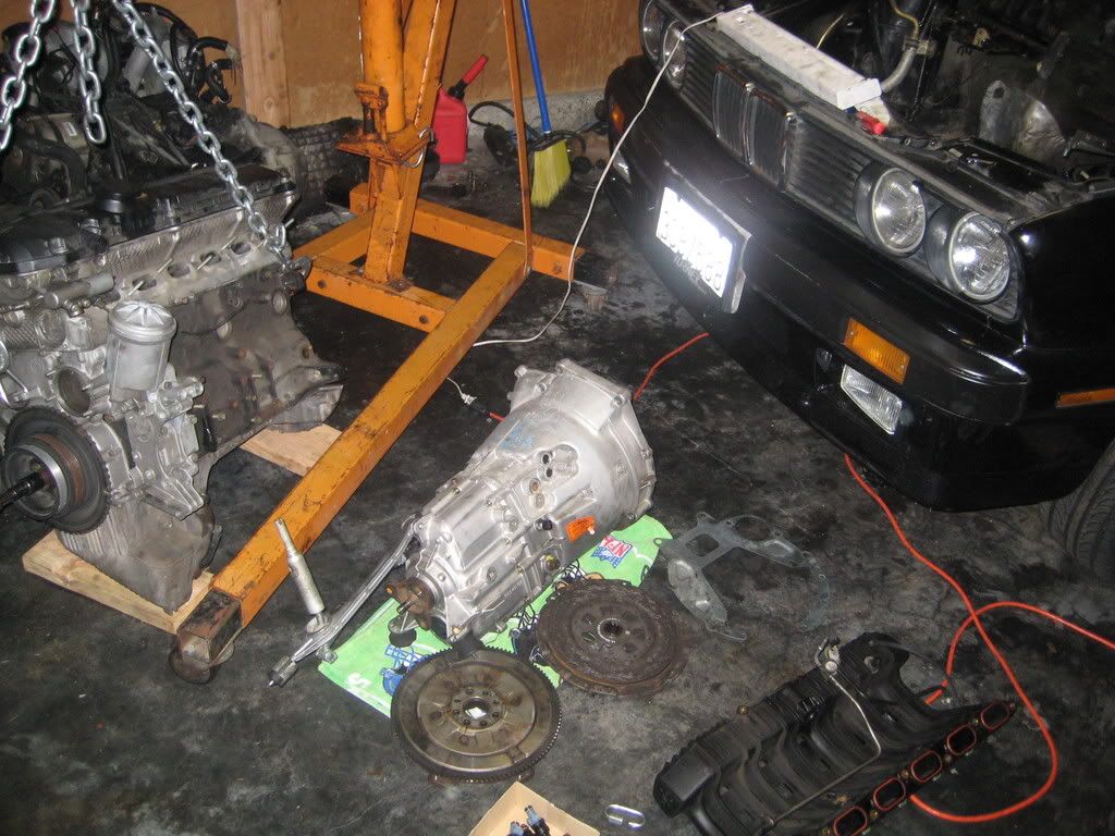

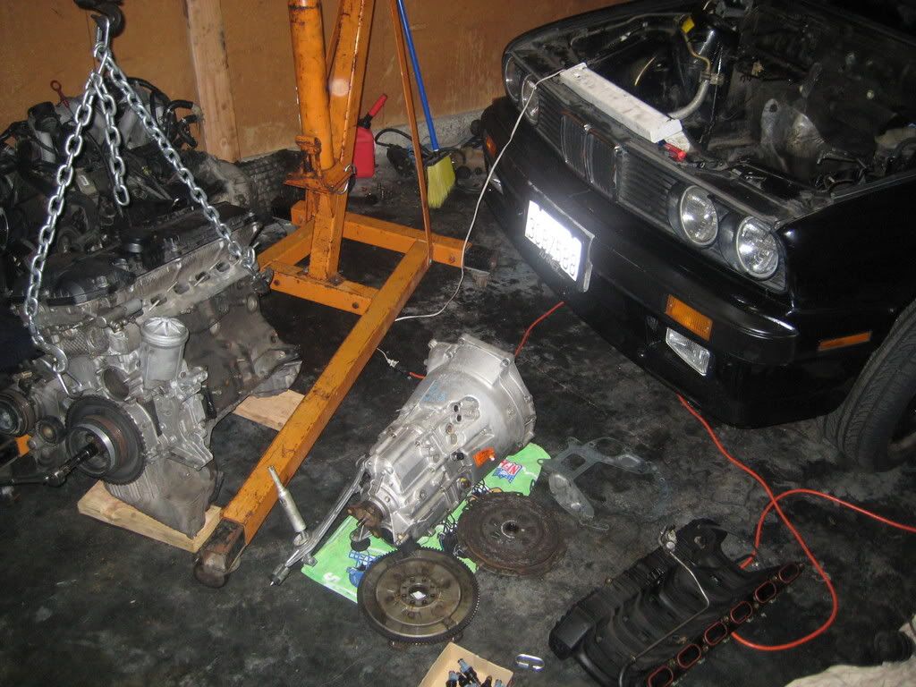

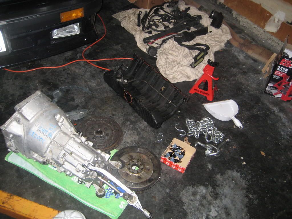

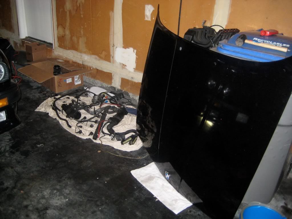

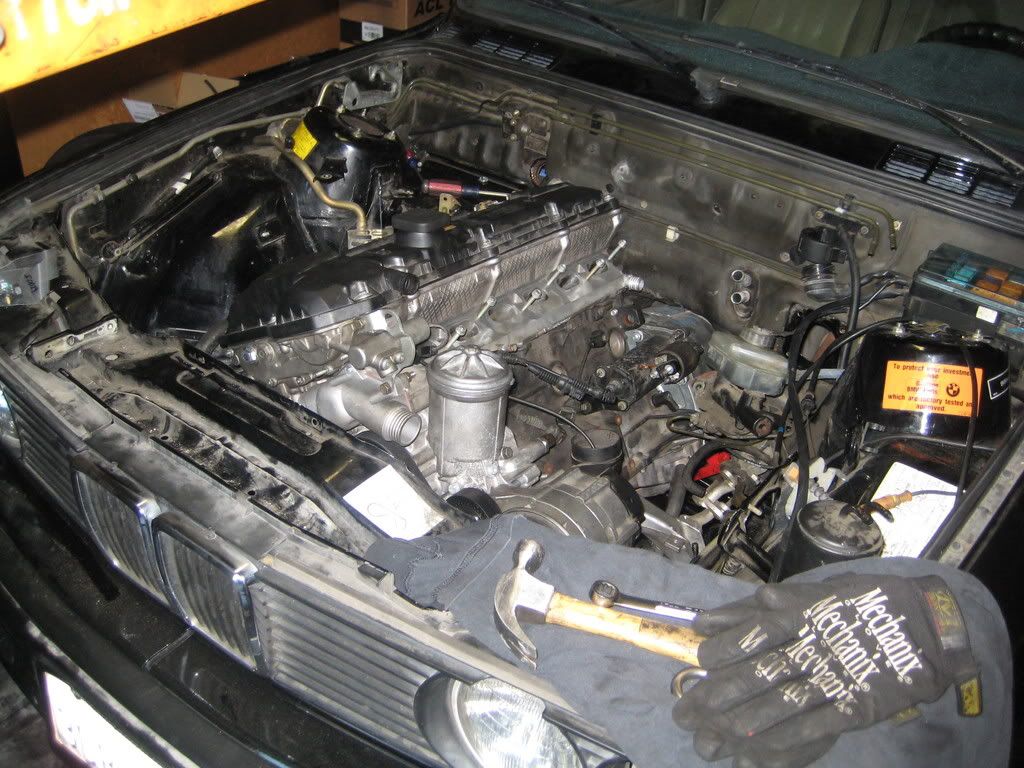

    After reading about these Dohc swapped e30's for a couple years now I have finally convinced myself that life cannot go on until I have one. So here are some photos of what I have done so far. (not much). And all the parts I have aquired so far. Originally I planned on trying to find an s50 since everything I heard was that it would be nearly impossible to get an s52 converted to obdI by a smog referee. That has now changed and I don't care anymore. I have a couple friends in the area that personally know smog techs that don't care if you give them a little extra $.( Don't care about the visual that is). So I plan on completing the obdI s52 by bimmerfest.(I'm well on my way) With a little help from my assistant eric in the white shirt.

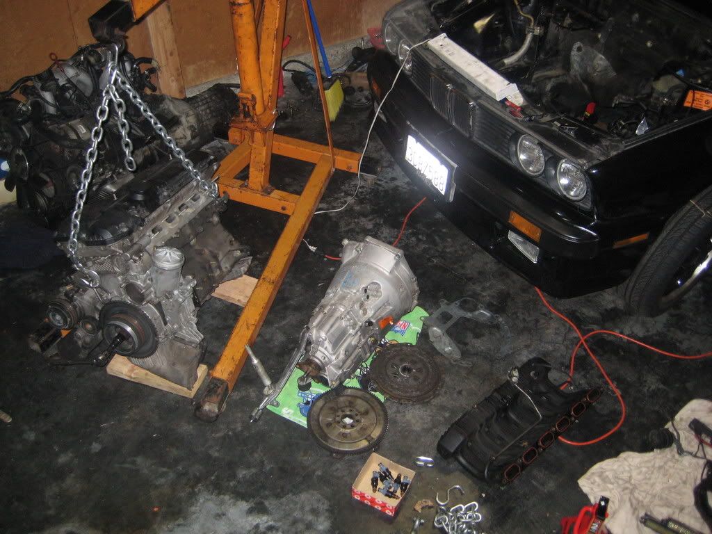

                slowly but surely it's coming together

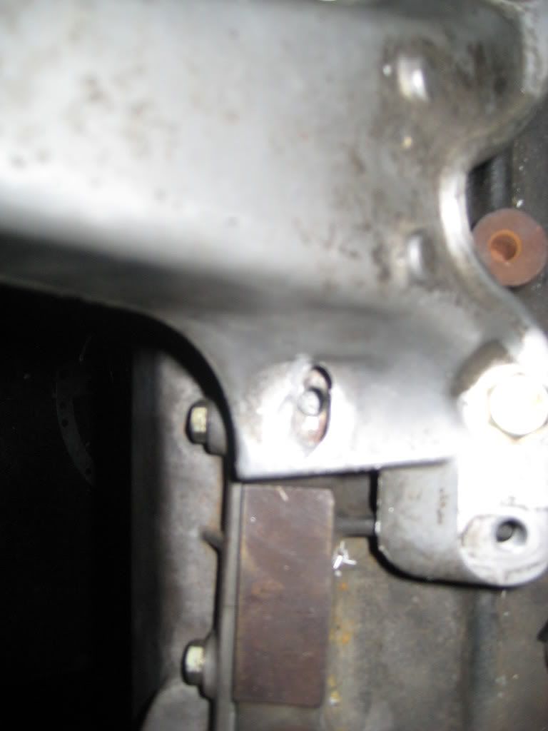

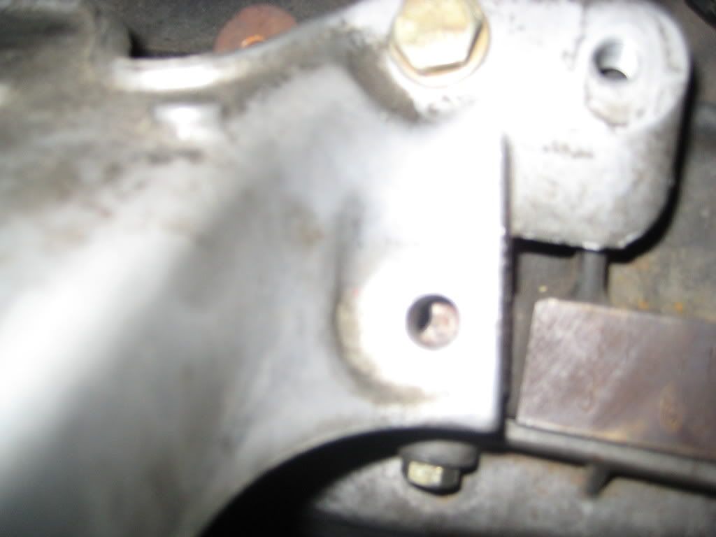

                This engine mount bracket is just barely off. I thought it was kind of weird noone else said anything about this. The only place I've seen someone else mention this is on the e3024v.com
                So I broke out the drill and wala........

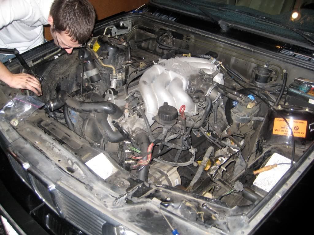

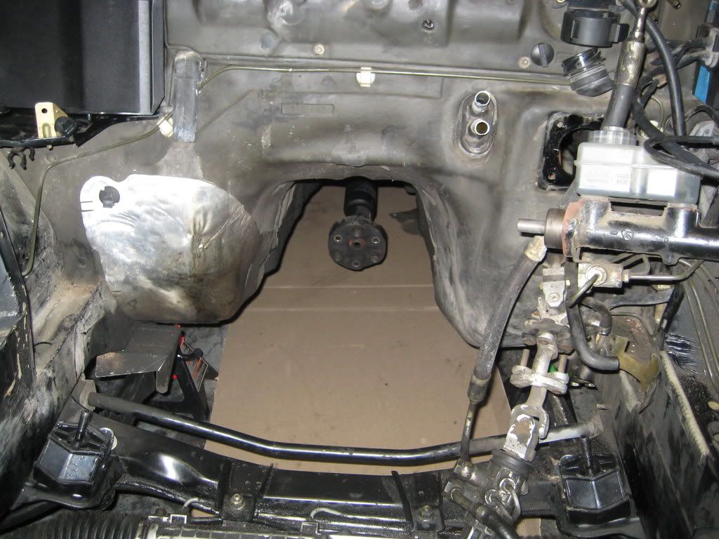

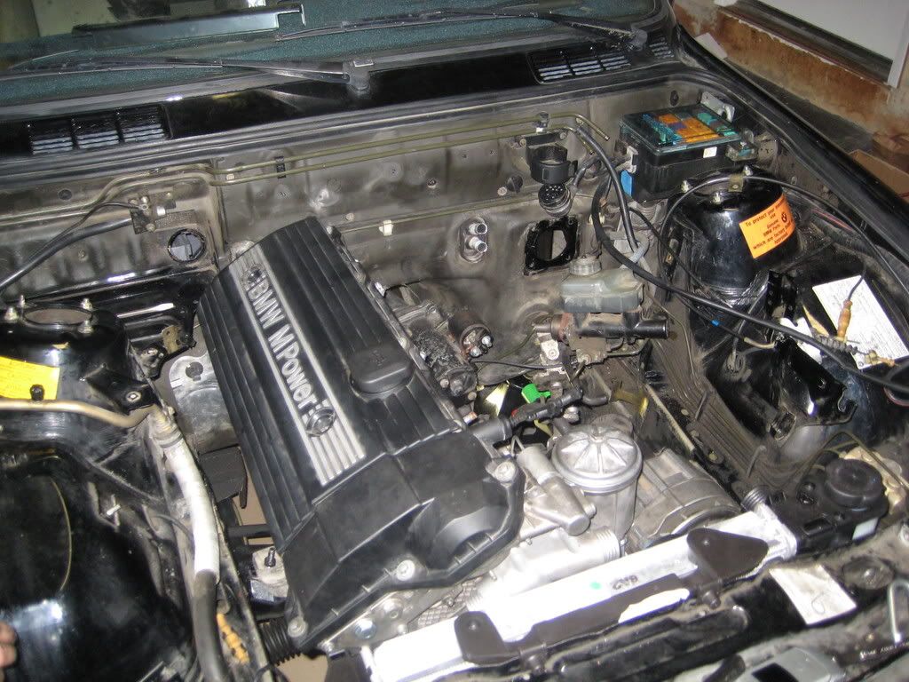

                Here's my empty bay

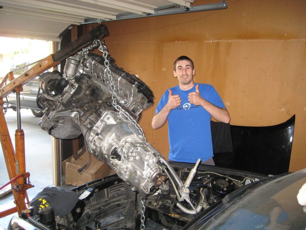

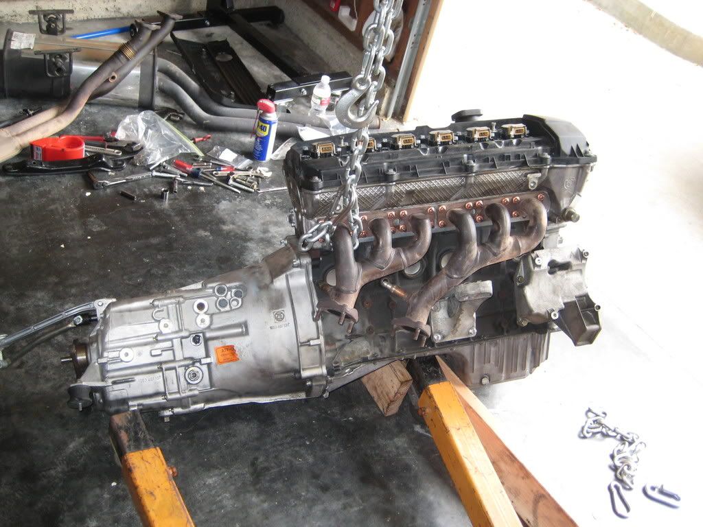

                Here's the engine and tranny all put together with all the accessories
                The moment of truth, I'm obviously very excited for this thing to finally be going in
                And there she sits as of yesterday
                And here she is again with that sexy m cover on
                Now I'm just waiting for the damn treehouse adaptor and booster to get here so I can wrap this up before fest hopefully.

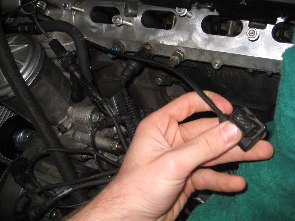

                      Next order of business is I'm having trouble with plugging in the camshaft sensor.
                      The one I have has a male fitting like so

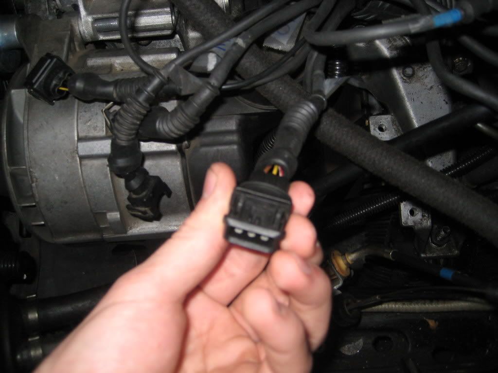

                      Here's the corresponding attachment on the harness, I double checked it (brwn/orge, red/wht, yellow).
                      I'm confused.

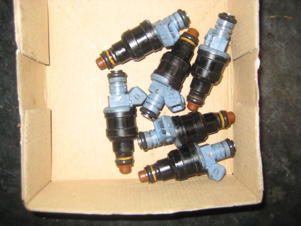

                      On a good note look what else I got

                        how many pounds are those blue injectors

                          are you sure you have an obd1 cam sensor?

                          • hugh jass
                            • 2220
                            24 lb.

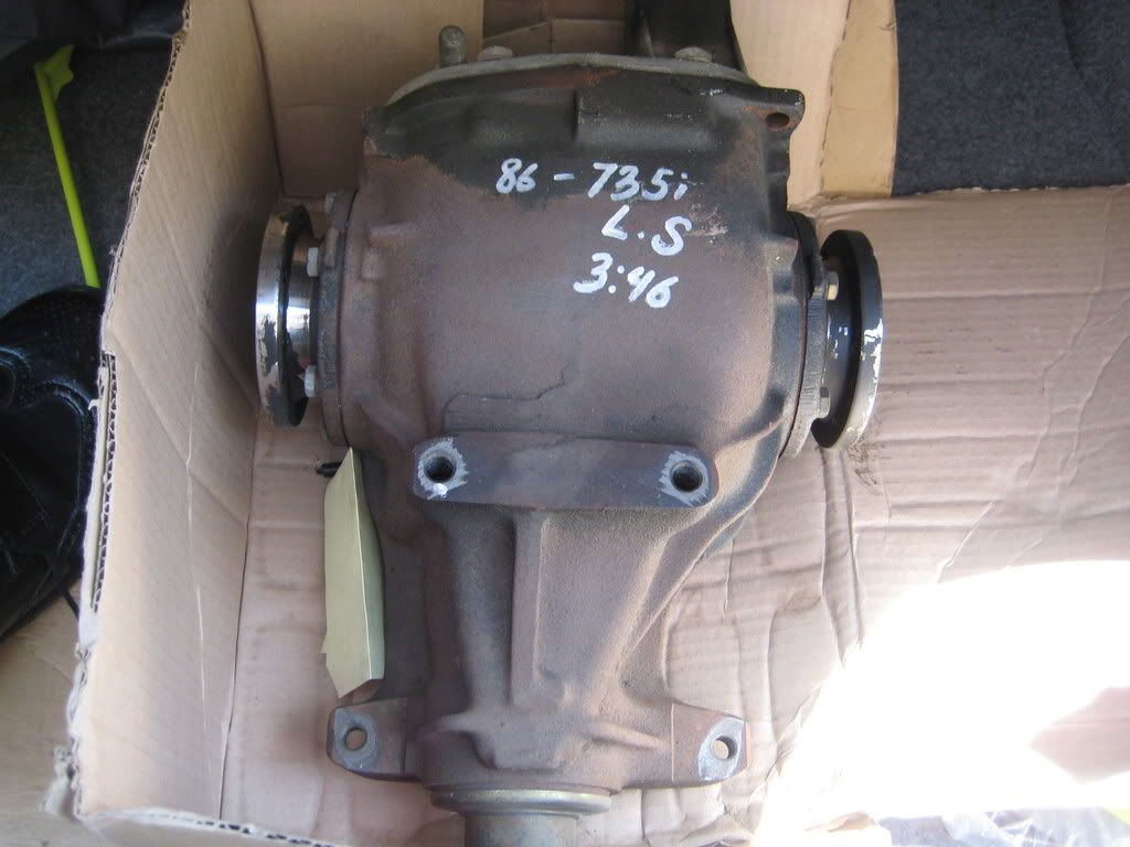

                              damn i have a 3.25 and the gearing is short as hell...what rim size will you be running?! you're looking at 60mph at 3000rpm ;d
