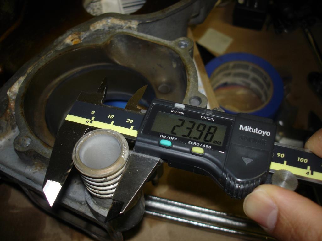

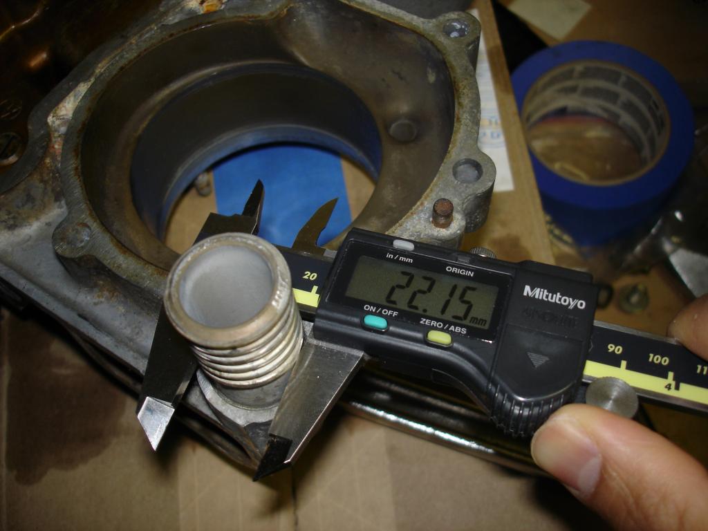

        Jean,
        What did you end up doing with your metal hose? Keep it? I need something similar to the Turner conversion fitting because I will want to replace my plastic hose (#6 here... http://www.realoem.com/bmw/showparts...00&hg=11&fg=35) with something that will let me use my stock power steering resevoir location.
        In any case, can you measure the ID of your timing case where the hose goes so I can compare it to what I have on the M54, I'd like to see if they're the same. I think mine is 30mm in diameter.
        • e30serg
          • Dec 2006
          • 562
          #109
          Here's what I found. I have both and s50 and s52 timing cases so I figured I could measure for you.
          s52 ID: 23mm
          s52 metal hose: 22mm. Yes, the O-rings fill-in a 1mm gap
          s50 adapter OD, the side that goes into the timing case: 22mm
          s50 adapter OD, the side that goes to the rubber hose: 24mm
          btw, .13mm = .005"

            #110
            s52 ID: 23mm
            btw, .13mm = .005"
            [ATTACH]14841[/ATTACH]
            [ATTACH]14842[/ATTACH]
            Thanks for the quick (and detailed!) response. The inside diameter of my similar port on the M54 is around 30mm so clearly the Turner solution... http://www.turnermotorsport.com/html..._ID=TEN9931007 ... isn't going to work for me.
            I either need to fabricate my own or mate a barb onto my plastic pipe at the right location. Or I can use the stock pipe as-is and live with some funky hose routing.
