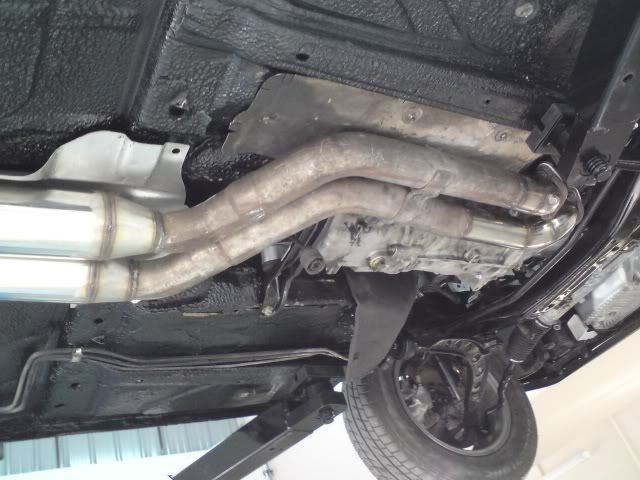

    I'm a little late but let me play too. My motor is Euro S50B30. I try to keep as many of E36 M3 bits as possible as I want the car to look and sound stock. Cats had to go though because there was not enough room so they were replaced with a pair of silencers to keep it quiet. Sorry no sound clips. Never started up the car yet.
    The exhaust shop didn't want to cut up the beautiful stock Euro BMW manifold so he custom made a new one.
    View from rear
    E36 M3 muffler and E34 M50 mounting hardware
    Heat shield moved to over rear axle to protect the rubber from heat
    Intermediate pipes replaced to match the E30 body
    Retained exhaust hanger which will mount to the gear box (not mounted yet)
    Side view
    90 E30 S50B30
      View from rear
      Side view
      really good looking work.
