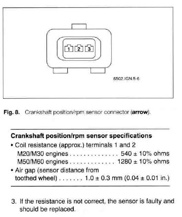

        Are you sure it's supposed to be at ~530 ohms ? I am looking at the e36 bentley and it shows 1280 +/- 10% for the CPS . I also looked in the e34 manual and it also shows 1280.

          chiltons say 540 ohms on the cps mine ran with 540? maybe 530 is to low? try swapig it out.
            You checked yours and it's measuring 540?

              yes sir its 540

                #37
                that's weird. so both e34 and e36 bentley manuals are wrong? hmmm.
                I just got a set of sensors in the mail today along with s50 manifold, so I'll measure them myself tomorrow on my lunch and post the results.

                  maybe the CPS should have 1280 ohms resistance?
