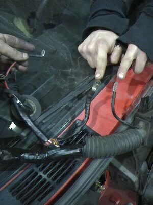

    Where do these wires go?
    Hey guys can you tell me, where do these wires go? There is three of them coming from my wiring harness close to the ecu plug end. 1 is red the other 2 are black.( this is for my m52 obdI swap )
    Thanks
    Loghan

    peel back the heat-shrink to see what colour the wire really is...
    There both grounds and hot in that same area...
    And what harness is that originally from?

      Ya I do not know what car it is orig. from? Only that it is a manual. The grounds I can figure out what to do with but wire to hook up the power?
        The red one is battery +...
        One or both of the other 2 are ground wires... I think... that is if that's an e36 harness...
        Need to know the color code of the actual wire.
          Wire on the left to power.
          Wire on the left ground.
          Wire in the centre where does it go? It is made up of 6 brown wires.
          Also when I have the power hooked up the the fuse box I do not have any power to the car. ie: when the key is to on position nothing lights up. Any ideas?

            Brown is ground and red is pos.
            • JGood
              • Jan 2004
              • 7959
              Just run a bolt through the body for the ground. The positive can be bolted straight to the battery cable junction point on the firewall. There is a fusible link there as well as the main constant power. I'd probably wire it to the fusible link if it's the ECU power wire...

                Alright all wires hook up and.... NO fuel comes out? What gives.

                  I should have fuel when key is on the ON position right?
                  sigpic I HATE SPEED BUMPS !!!!!
                  • jakeb
                    • 1909
                    no crank = no fuel pump. It might prime but it will not just run when the key is in the on pos.

                      You have one of your hot lines grounded.
