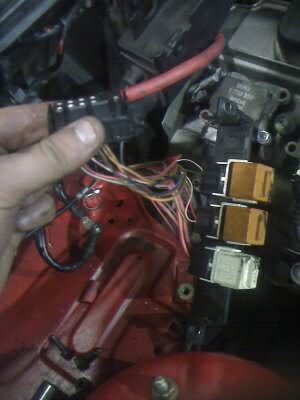

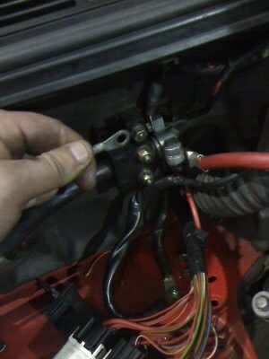

                  Still no spark or fuel. Where does this wire go? It runs parallel with the main power wire. Does it get grounded or hooked up to power?
                  sigpic I HATE SPEED BUMPS !!!!!

                    And how about this plug that is wired with the harness? Do I do anything to it?

                        Dude like my post #38 is a wire from the e30 can[t remember where it goes and what it is for you know?
                        And is the plug needed?
                                This is also a power wire that is hooked up to +12V, but it is protected by a 50A fuse in the trunk, called a "fusible link". Should there be a ground fault somewhere, it will blow and protect the electronics in the car. Normally people will power the DME through this lug.
                                I am fairly certain you don't have to do anything with that plug. Maybe some folks that have done the conversion with an E34 harness will know better.
