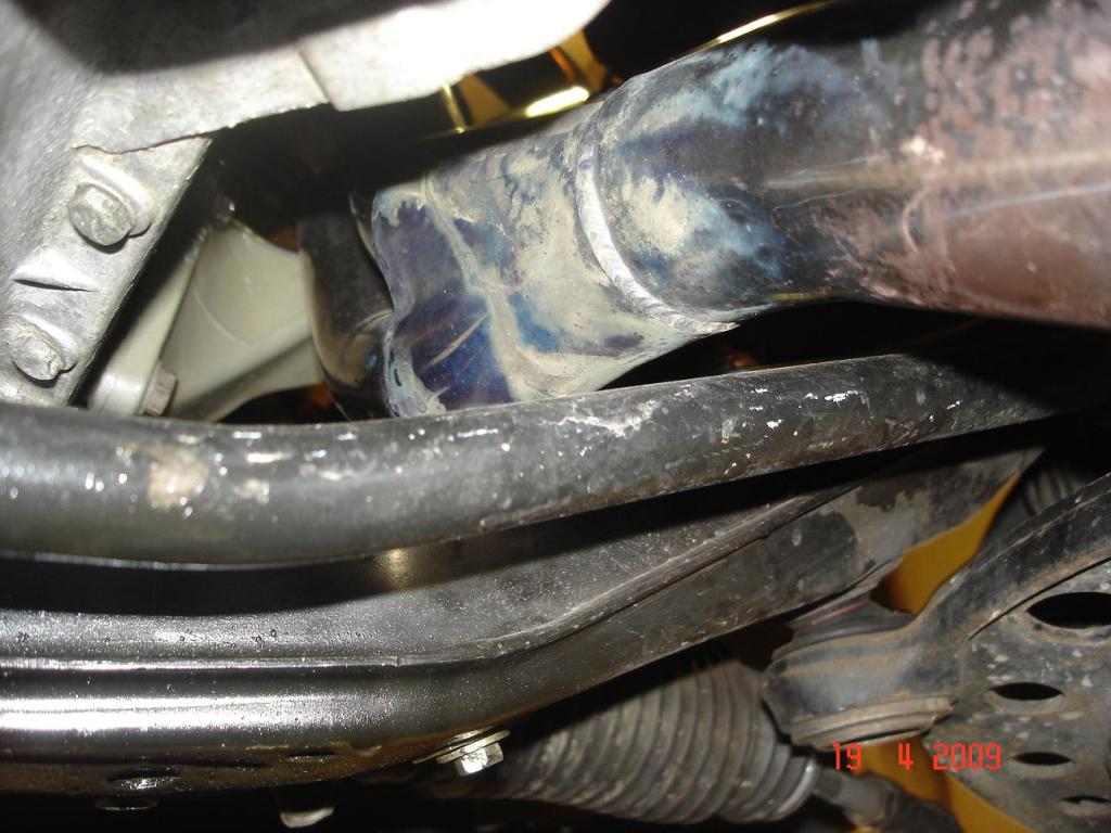

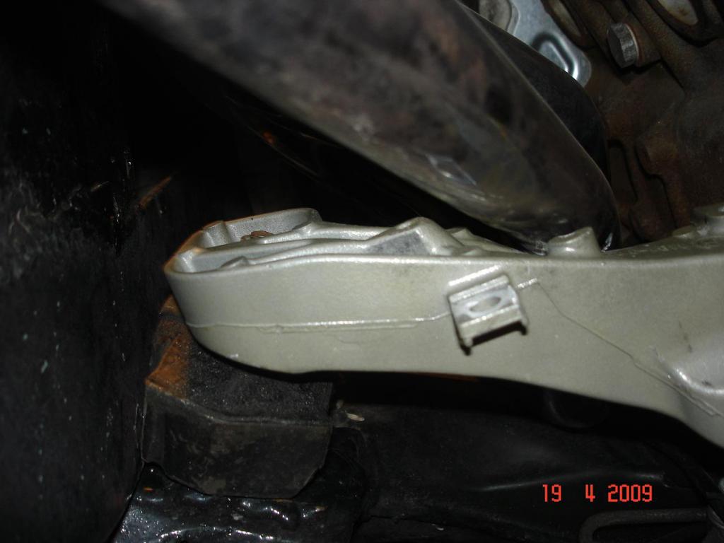

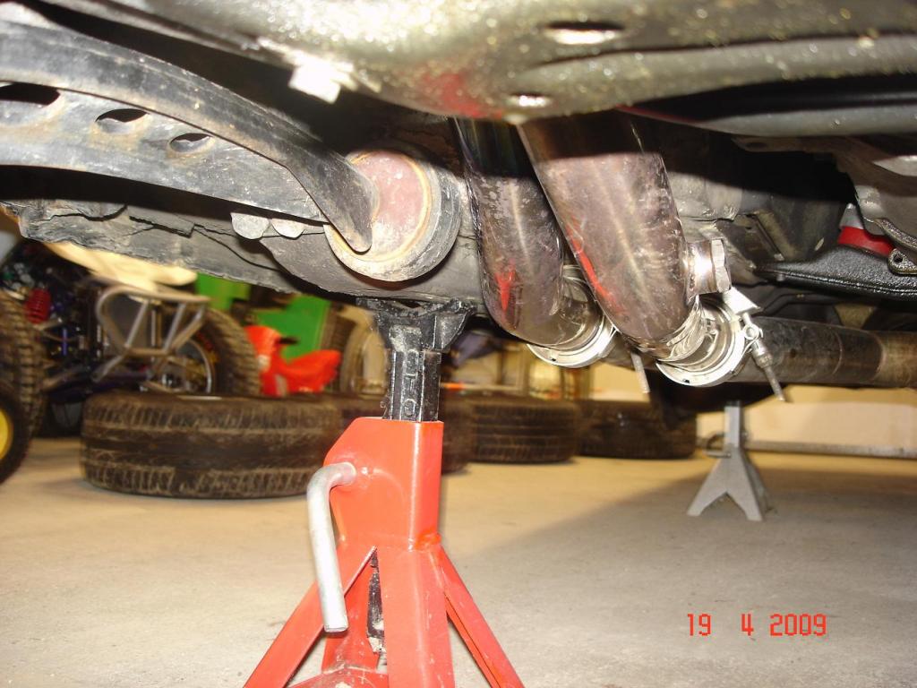

    SS rep pics.
    I couldn't get a good shot of the clearance to the subframe, but these should give you an idea of the other tight areas.

      Thanks for posting up those pictures, I appreciate it.

        Hope it helps.
        I forgot to mention this before, but I did take down some of the mounting arm where is was contacting the header tube.

                  Here are the pictures of the spacer that my dad made with his buddy's mill.
                  And the clearance that this spacer made. Before this spacer sway bar hit the header.

                    Can you post a more detailed pic showing what you did with the "tab" end of the plate?

                      Hmmm, the new UUC stuff does end up pushing the sway bar down a bit, how thick is that spacer?
