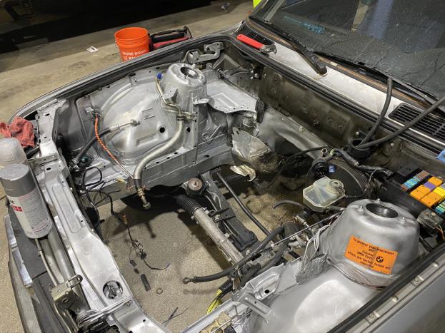

      Well I'm very close to wrapping up the PS rack swap. My progress was delayed by Garagastic shipping out slowly due to COVID. But then I realized I lost a few crush washers (I swear I put them in a good place!!) so now I'm waiting on those. A friend told me an M50 E34 was at the local junkyard, hopefully it has a good rad and expansion tank, along with the OBD-I mani brackets and the dipstick. Those are the last parts I believe I need

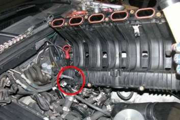

          FPR vacuum line: where in the world should I hook this up? Maybe off the charcoal purge line as I am not running a charcoal canister? I have the vacuum canister with one of my m52s, but I thought that was for the exhaust flap. On my friend’s S52, the FPR line went straight back to the tank I believe.

            Nevermind.. That is to the exhaust flap. Vac source from the manifold is the red circled. I think I have my OBD-I fuel rail (I hope!)

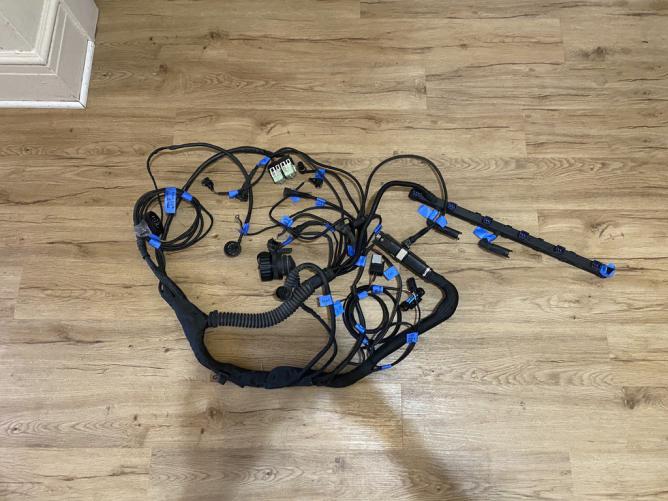

              I received my harness today!
              Very excited now!

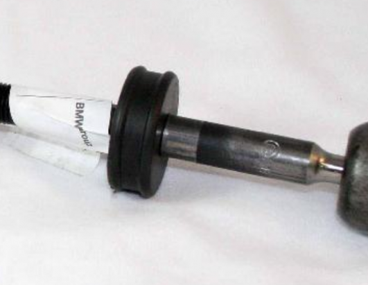

                Well, I made a mistake and threw away the rubber grommets on the tierod ends that the boot straps to. My boots were super gone, but I figured a boot/bellow kit would come with the new grommet. Nope.
                Only comes on the entire tie rod end assembly.
                Thanks BMW.
Name:	Screen Shot 2020-06-04 at 5.08.56 PM.png
                (this is the part I am referring to)

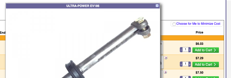

                Anyway, Rockauto carries a $6.03 inner tierod, so I figure I'll just spend $15 (tax+shipping) and do that, unless anyone has a part number for this specific piece? RealOEM did not note anything except the entire inner tierod.
Name:	Screen Shot 2020-06-04 at 5.10.04 PM.png

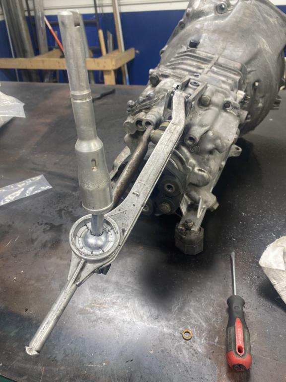

                      I rebuilt the shift bushings today and applied a bend to my shift selector. The Delrin bushing kit from Gargastic took 15 minutes to install. Easy peasy. I also ran the E34 accelerator cable and put a new grommet on the pedal-side.

                      Did a very quick engine bay paint job:

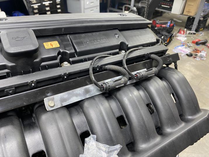

                      Also had a friend make a bracket for the O2 sensors on the fuel rail since the M50 rail does not have the provisions for holding the tabs. It was cleaned up and painted shortly after this pic.

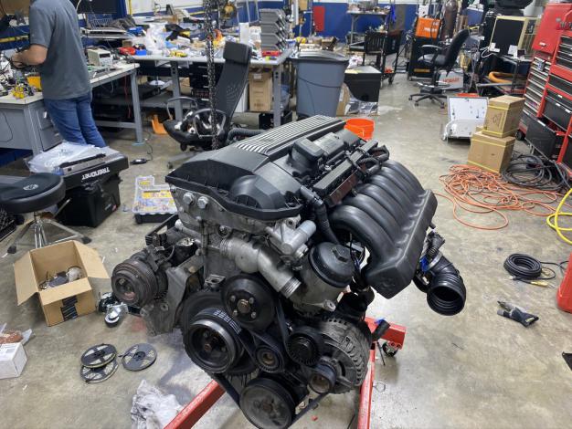

                                Engine finally went in today:
                                IMG_6029 by keaton.burleson, on Flickr
                                Was so nice getting it off the stand.
                                Exhaust headers need to be modified, as well as the down tubes.
                                IMG_6030 by keaton.burleson, on Flickr
                                Just need to: build A/C lines, install and wire up fan. Move coolant sensor wires. Finish shifter shit. Install driveshaft. Finish power/ground wiring. Install fluids. Mount the power steering reservoir somewhere. Find a filter that clears the expansion tank. Bleed brakes. Bleed clutch. Mount the diagnostic plug. Run check engine light and speed sensor plug to dash. Get a grommet or something for the wire loom into the cab.
