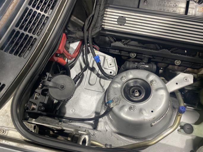

      Finally got to drive the SOB after grappling with the t-stat issues. It finally opened. I'm thinking I need a puller fan on the other side of the rad, as the temp just kinda hovered between the halfway and 3/4 mark. When the SPAL fan kicked on, it brought it down to half way, but it didn't stay on long enough or kick on fast enough for my liking. The brake booster is now a vac leak, so I said screw it and ordered an E92 booster and master off ebay, along with the rest of the parts needed to relocate the reservoir. $100 all in, which I believe is worth it.
      Rack still needs to be bled.
      I did mount the diag port and the coil pack plug with some zip ties.
      I also wired up my caddy horn I had laying around. Sounds pretty sweet.
      I need to mount my expansion tank, but I'll wait until I remake the brake lines for the new booster.
      Engine covers hopefully here by this weekend. Really ready to button this thing up and driiiiive.
