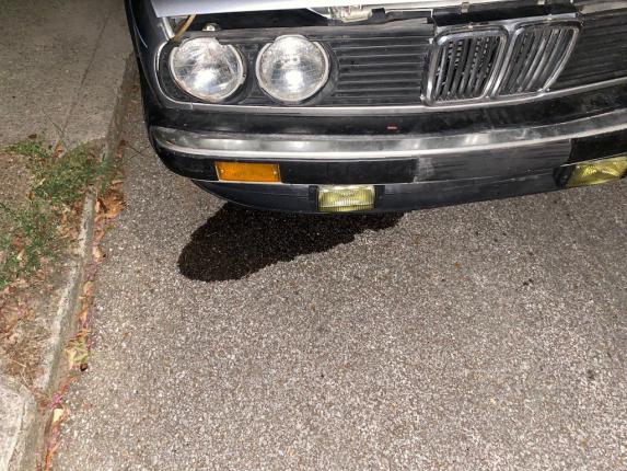

                            I've been monitoring some coolant loss and I was pretty sure it was the cap until today when I find a puddle on the right hand side. My t stat housing I believe is the source, as that was the problem "area" (snapped housing bolt gone wrong). Yuck. I have a spare head but it would need to be planed and checked for cracks. That or weld a stud on it if I can find someone to weld aluminum.
