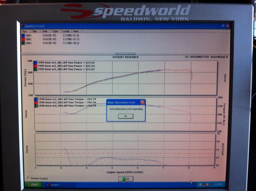

                      Originally posted by bimmertc
                      thanks for all the comments guys, it's a blast to drive, taking it to the dyno this week,g
                      Finally got take it to the dyno, did a couple pulls for baseline , got 322whp n 266 torque, time to put on the csl intake n go back,

                        • nando
                          • 34844
                          should pick up a bit more power if you get rid of that pig rich area too! :)

                              • bimmertc
                                • Jul 2006
                                • 38
                                i saw that it went crazy rich after 6500, the tune is a mild street tune, the intake setup is basically stock except for the bimmerworld elbow, i have a csl oem intake that i'm going to try next before i do any changes to the tune, we did 2 pull to 7k, then a 3rd to 8k in 4th gear the power was still strong at 8200, i love the torque very linear from 4k, gonna do some 9k pulls with the csl intake i wanna c where this thing stops, then after that do a race tune, before i put the 3.4 in
