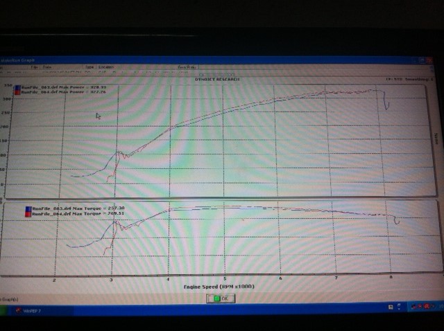

            #50
            took one of my s54 swaps to the dyno, still need a brush up tune we got 328.33whp n 269.51 ftlb, we went to the drag strip(e-town) last nite, the tach wasn't working so we had to shift without it, we did a mid 12's with a 1.8 60ft, gunning for the 11's i know what we need to do, car was on street tires 17's

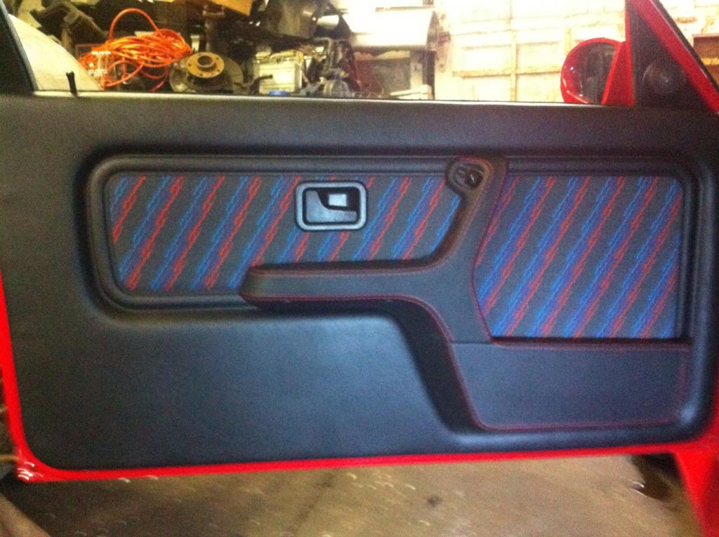

                  Bimmertc, can you elaborate a little on the brake setup and what it took to put the BMW Performance brakes on the E30 M3?
                  • bimmertc
                    • Jul 2006
                    • 38
                    #54
                    Originally posted by Gregs///M
                    Wow, impressive everything. That interior is to die for.
                    Thanks, oem door cards with leather wrapped handle n pocket, sorry for the crappy pic, brake booster is from a 2002 tii, i'll post a pic tomorrow of what i did for the 1 series bbk

                        #56
                        http://www.youtube.com/watch?v=3bJz3...m-upload_owner been a busy summer last yr, had a chance to play with the tune on the car, it now dyno's 337whp n 270ftlb torque, not sure how much more torque i can squeeze out, i know there's more hp to be made, the motor is 100% stock down to the intake manifold, the only mods r pullies, tune n custom exhaust
