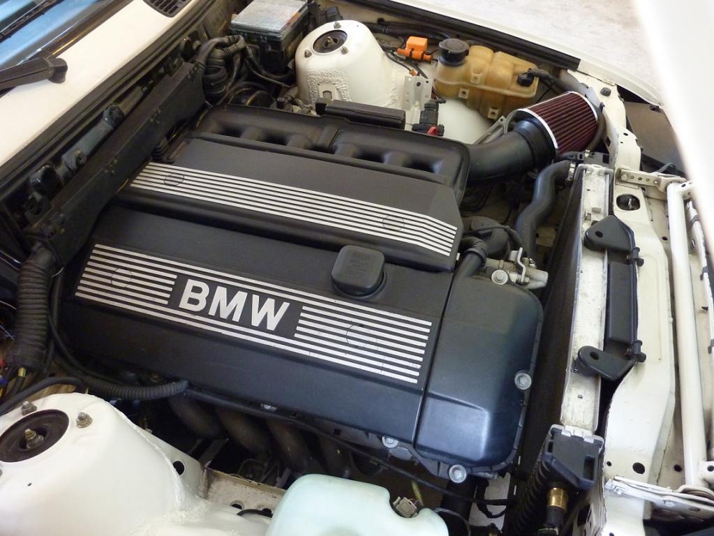

              Here's what it looks like in an e30 (with an OBD1 harness):

                  I am also using E46 power steering lines without cooler. As you can see in the photo dual vanos engine package installed, and you see the plastic DME holder with relays, that’s how you should get your engine, if you get it with harness all cut up then it may be a problem getting the right harness.
                  You can see here the S52/M52 exhaust manifolds with 02 sensors installed, then the lines wired to the block so that they don’t touch the manifolds. Rear 02 sensors are not required with my programming.
