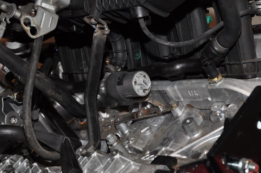

    Current status is that the IAC bracket is fabricated.
    I'll be pulling the cams and then head in the next several weeks, need to figure-out what I'm doing as far as valve grind, guides and so on. It's a low-mile motor, so nothing probably needs to be done, but a good valve grind can make a big difference.

  • hoveringuy
    replied
    Megasquirt.
    The MS43 is a great ECU but it's not as easy to tune and maintain as the Megasquirt. Plus, I can easily add traction control and some other cool functions.
    My current status is that I'm fabricating the the ICV bracket. After that, the head will come off.

  • hoveringuy
    replied
    Originally posted by MasukBMW
    Updates? Thought this build would fly this time
    This wont' necessarily go that fast. I have lots of other things competing for my time and money...
    Anyway, I did go and pull a complete M50 intake the other weekend. Came with absolutely everything. After pulling some of the extra studs on the head it bolted-on beautifully.
    The support strut to the block was a quick and easy mod.
    The current task is that I need to locate and mount the ICV. The m50 has it attached to the block at the wiring support bracket. The M54 has it attached to the bottom of the manifold. I would prefer to have it on the bottom of the manifold so that it will lift off as one assembly, so I need to resolve that.
    After that, I'll pull the head and match the ports. My latest intel is that the motor had closer to 67k miles, so the head won't need any work, but I'd still like to match the valve guides to the port wall and other minor porting.
