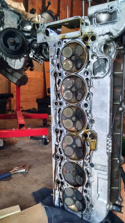

I borrowed the appropriate templates and cut the intakes to match the M50 manifold. With the right burr it took about 2 hours. Still need to plug the idle passages and do some minor work on the exhaust ports and then the head goes to the machinist.
The one on the left is done and the one on the right shows about how much material is removed. The blend goes about 1" into the port.Leave a comment:
Head is removed. Everything looks good except for some scoring on one of the exhaust cam journals. There was also enough loose carbon in each bore that I could vacuum it out; like a teaspoon of carbon was sprinkled on each piston.
Valves will be removed. Port will be matched to the new M50 intake manifold, the ports will be cleaned up a little bit (mostly exhaust!) and then the head will go to machinist for good valve cut and assembly.
