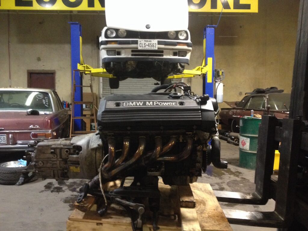

              I'll be running e36 m3 fronts an 318ti rears, deleting my broken abs and it's not my daily but can be if I want.
              The booster delete seems like the easiest way around it
              No turning back now
              The s52 is out Click image for larger version
