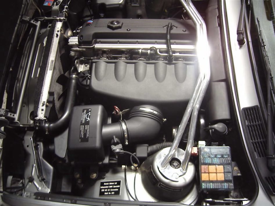

    I saw a pic of one on s14.net that is gorgeous but couldn't figure out what it is maybe someone here can tell me
    This is "lulu" car I guess. Click image for larger version

          Can anyone identify the one in the pic I posted it doesn't look like an ix booster but then again it's hard to see
