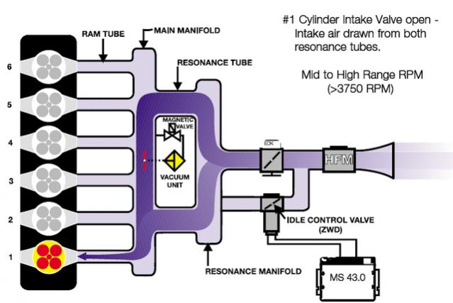

    Hey guys can this DISA valve be totally deleted out of a m54?

    I'm sure it could be but why would you want to? you lose out on all the low end torque benefits.

      It would work. You could remove the DISA assembly and replace with a blockoff plate.
      The result would be that you are permanently using the runners that correspond with higher-rpm operations and would lose the resonance at low rpms that boost torque.
      Your MS43 may also throw a code if it does't sense the actuator.

          a lot of that torque comes from Disa
          there would just be a couple error codes from the missing actuator. you really don't even need to delete them, they shouldn't cause a limp mode or anything.

                Oh and you want to keep disa,
                  Yes I can delete that function from the MS43.
