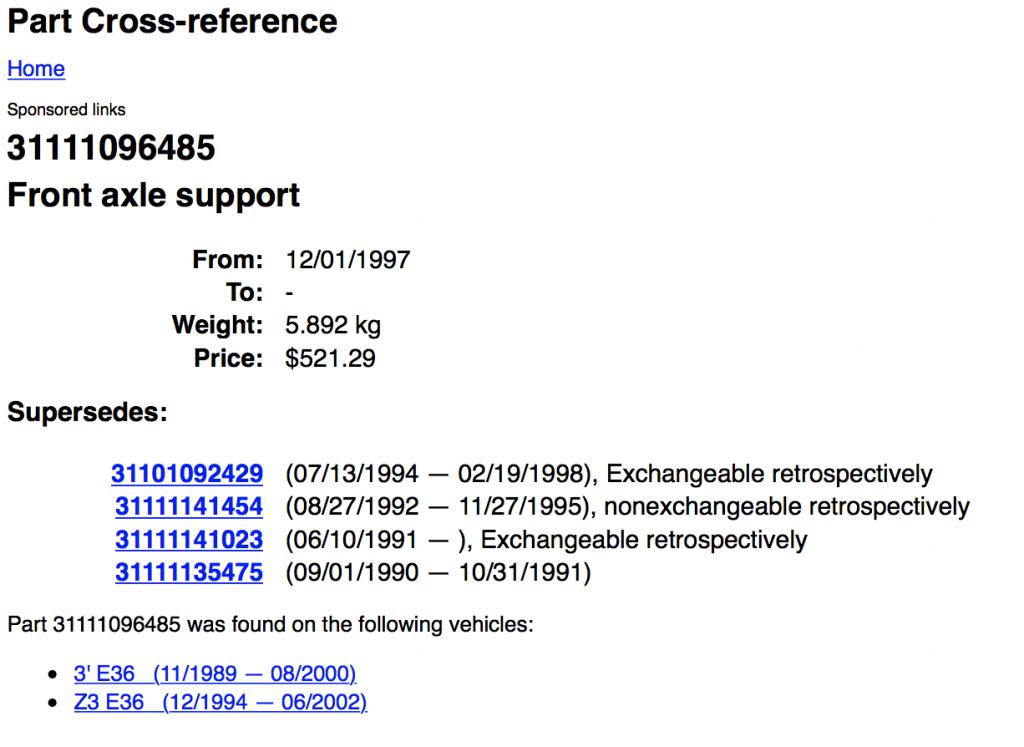

          Originally posted by bimmer630
          The struts and arms are E36.. But the subframe looks like it would bolt right into an e30
          EDIT: Ive talked about this before (just found an old post). They "would" work with mods, but dont really bolt in
          Based on what?
          The Z3 front subframe is literally the E36 subframe.
