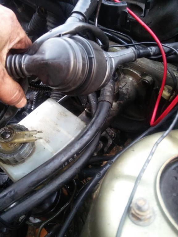

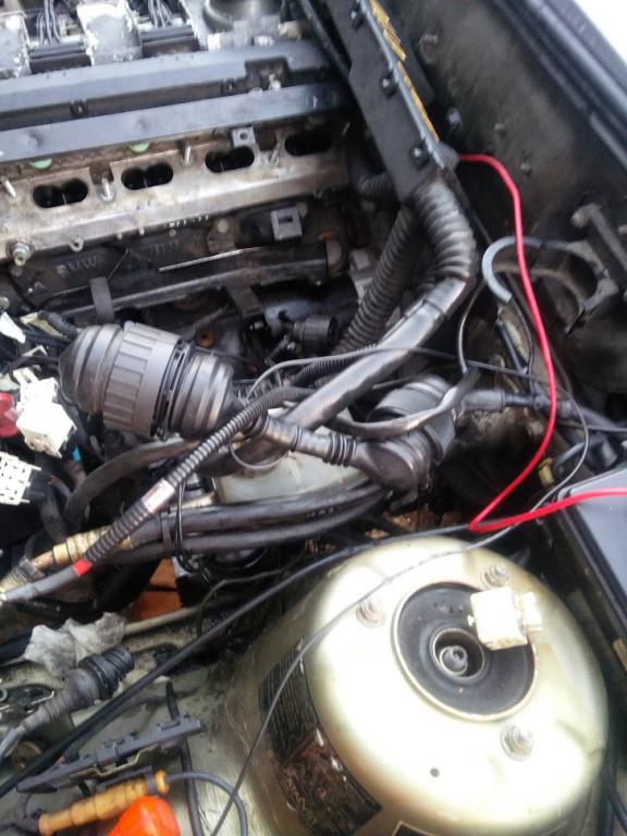

I would like to just throw out the idea of using an E23 or E32 hydroboost setup, it will require more complicated installation, but the space saving may be worth it, not to mention the alleged outstanding pedal feel. I have both units if anyone wants pics.Comment
Pics would be great1989 332IS -S-Fiddy Four-Some weight removed.
5 lug E36 M3 Brakes Coilovers and LTW's and No ABS.Comment
The one on the right is the e32 one, and the one on the left is the e23 one. I've only tried using the e32 one so far and it bolts right up to the e30 brake pedal. Meaning the length for the clevis would not have to be modified. The other two pics are for the supporting hardware, it's a bunch of stuff but it also can be located anywhere in the car.
Sorry for the bad quality, phone camera broke recently.
doyou have pics installedThe one on the right is the e32 one, and the one on the left is the e23 one. I've only tried using the e32 one so far and it bolts right up to the e30 brake pedal. Meaning the length for the clevis would not have to be modified. The other two pics are for the supporting hardware, it's a bunch of stuff but it also can be located anywhere in the car.
