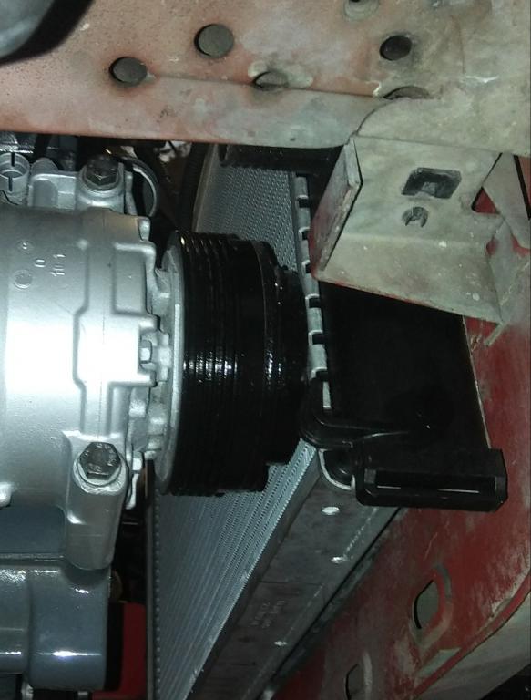

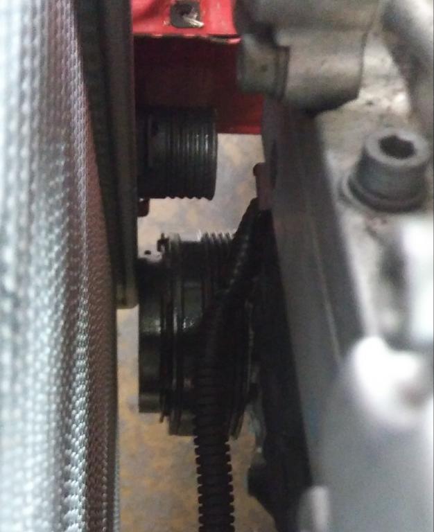

    Using the new style (thinner) z3m radiator and the end tank rests directly on the compressor. Couldn't imagine the thicker core fitting.
    Anyone else have this issue? I'll figure a way around it, just thought someone had to come across it before.

    is that an e30 compressor?
    • nando
      • 34839
      E30s don't have serpentine belts... so I'm guessing no. :p
      Build thread
      Bimmerlabs
      • ForcedFirebird
        • Feb 2007
        • 8300
        E46m3 engine and compressor.
        Ended up moving the engine back 3/4" which makes the head smash the firewall insulation. Will see about NVH, might be an issue with the m5 OEM mounts, but the owner was very against solid mounts.

            How exactly did you move the engine back 3/4"?
            I think most people use the E36 compressor. Maybe it would have more clearance?
            • ForcedFirebird
              • Feb 2007
              • 8300
              I used a large pry bar and shimmed it in place for now. Used a 3/4" piece of wood between the oil pan and sub frame. The compressor clutch now has about 1/4".
              Not sure how the e36 compressor would make any difference as the belt will be in the same location and most AC clutches are similar in size. I have some at the shop. Took the day off today for a change, but can verify when I go back in.
