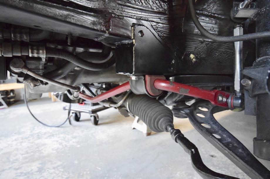

    I wish I would have added a jack pad to my arc asylum front sub frame before I got it powder coated...
    Do you have better pics of swaybar mounting?
    They can be either thru bolted or welded as shown. You can see where I plug welded the holes. That is where the bolts would go.
    Click image for larger version  Name:	fullsizeoutput_5f1.jpeg Views:	0 Size:	77.8 KB ID:	9862393

      Do you sell those brackets seperatly?
      Anyone used E36 bars? Or too wide?
        I can sell the brackets separately. E36 sway bars vary in size and shape FYI. M3/325/z3/318ti are all very different.
          Architecturally the bars are interchangeable on the E36.
          So any E36 bar should comfortably fit if one, the m vs non M does fit.
          E36M bars has a good aftermarket selection of diameters, along with stock.
          So has anyone fitted a E36M front bar?
          Using the S54 conversion subframe seems like a good time to see how one would fit there.. Which this is my next step..
