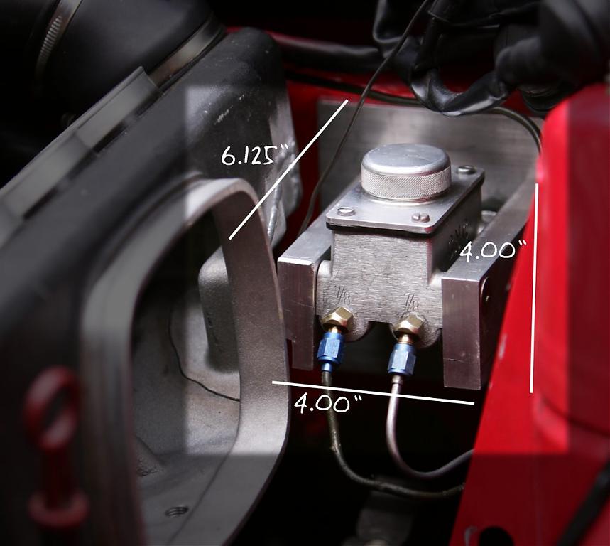

        BTW I have a nice solution for the brake booster issue. v2.0 is weather tight and fits in a nice small package (4x4x6.125). No fitment issues with the euro 3.2 intake, so I assume it would be fine with the S54 intake.
        Do it, Fred, do it... Cave in to the peer pressure...
        pics of said booster solution???

          Here is a pic of the v2.0 prototype. The final version will be a bit more polished looking, but you get the idea.

                  • Teaguer
                    • Sep 2004
                    • 6167
                    So theres no power assist then ?
                    • Mike B.
                      • Jan 2006
                      • 987
                      Nope.
                      Master cylinder size is spec'd to accomodate this.
                      • FredK
                        • 14762
                        Looks pretty sweet! :D
                        I notice there's some welding done to the plenum--this looks like it might have been done while you were futzing around with different brake booster combos, because this v2.0 prototype looks like it clears no problem! Did you decide on dual 7/8" MCs for front and rear?

                            I am using 3/4th (19mm) masters for the E30M3 brakes installed on the car. It's a pretty firm pedal because the pedal ratio is around 4:1, but it will be very nice for the track. The 7/8th masters in the picture above are installed on another car.
