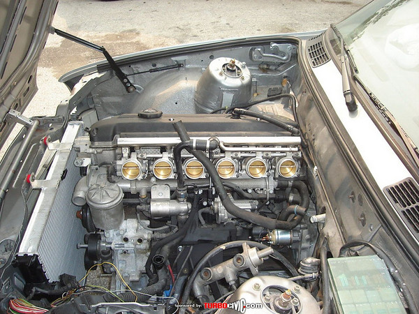

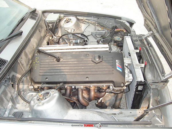

                          Fred , hows this for inspiration :
                          Looks like they fabbed up some custom mout arms ala M30 swap style .
