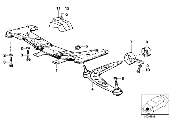

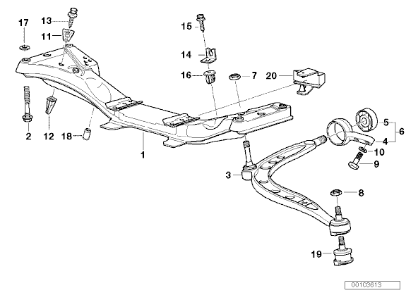

        Originally posted by FredK
        Maybe I'll go to the junkyard and scope out what the E36 front subframe looks like.
        The front subframes look remarkably similar with the E36 one a bit deeper in the middle. The main issue comes with where the engine actually sits in the engine bay. The engine in the E36 sits farther back and allows for the rear sump placement.
        What would be cool (track car only) is to remove the heater core and related parts and move the fire wall back to accomodate the rear sump. Although, this would lead to a host of other custom parts such as the mounting arms, shift carrier, drive shaft, etc.
        Big plus is that it would significantly help with weight distribution.
