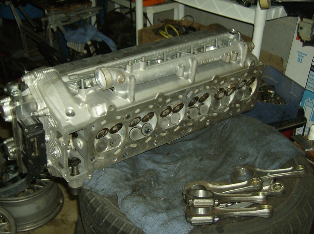

                            :pimp: just a little something lurking around in the garage
                            Check out those ports
                            85 325e 2.7 ITB'd stroker
