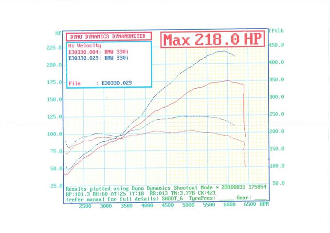

        Originally posted by hoveringuy
        You're power curve looks much different without VANOS and DISA, but 250 torque... holly sh!t.
        Great job!
        that is because 250rwtq is not happening, do the maths on a 3L with those numbers and the specific torque output would have to be one the highest of all time

                  250rwtq is about 295lb-ft @ crank. That would be about 98lb-ft/Litre which is just not possible in reality regardless of whether there is a printout that says it. The BMEP is too high. It would have to be the best NA engine every built to make those numbers.
                  Do the maths and physics, read off the graph the power is approx 193rwhp@5000rpm (by eye)
                  Power = Torque x rpm / 5252
                  Therefore Torque = 5252 * 193rwhp / 5000rpm = 202rwtq
                  The numbers don’t add up.
                  The power figures look normal maybe the rpm pickup is faulty or the curve is not rwtq but some other value.
                  Some times with dyno dynamics they convert rwtq to tq by correcting for coastdown losses (about 20% is a ballpark number) but there is usually a ‘S’ near the units to indicate this.
                  In any case the car doesn’t put down 250rwtq.

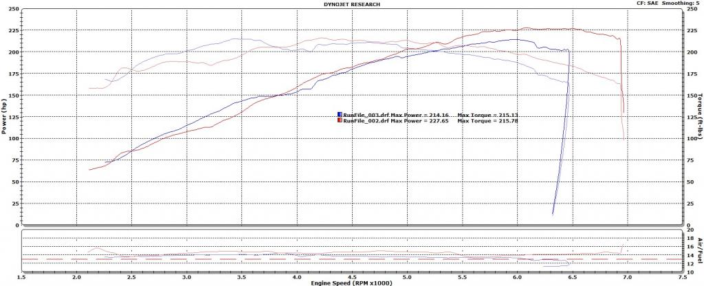

                    As a reminder, here's about the best I got. The M54 just doesn't flow that well and a bigger bump on the cam won't help that.
                    Does fantastic on the bottom but doesn't carry as well as an S50.
                    This is with ZHP cams compared to normal cams. I got a few more hp.
                    Here's my M54 vs an S50. Same dyno back to back.
