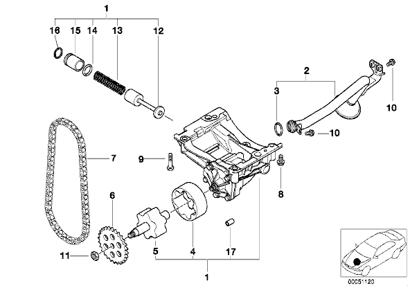

    The M54 oil pump mounting flange only has one bolt, it's a different design with an O ring instead of a flange. The pickup will also need to be supported in a second place.
    If I go with an M50 pump, I will also need to swap the sprocket and the chain. The M54 sprocet has 26 teeth; M50, 25. I could use the M54 sprocket on an M50 pump, but then it would turn 4% slower. I don't know if that would make much of a difference.
    So, it looks like for the M54 BMW gave it larger impeller but drives it slightly slower. Could that be for double VANOS oil supply??

    I think you might be able to just use a m50 pump and pick up

    It's time for an update...
    Cylinder head is back from the shop. It was heat straightened and decked .004. Good as new as far as I'm concerned and I'll even use the stock head gasket.
    The block had pulled threads and I've installed 30mm Time Serts. Baum tools wants to sell you the 24.5mm ones for this but I've talked to some guys that had those pull out of the block, too. There's a reason no one says "tough as Aluminium". It's not a very tough metal and doesn't like getting hot. My block is fine now.
    Anyway, I got the standard E34 oil pump and pickup tube and was messing around with that tonight when I realized the M54 oil pump is all different. Not even close. I will either need to switch in an e36 pump or fabricate a custom pickup tube. The M54 pump looks like it's got a larger capacity impeller. Anyone know for sure?
    You be the judge... m50 vs m54 attached.
