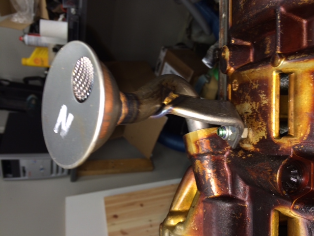

    Just wanted you to know, that e38 728i has a pickup, that fits perfectly. My pic is from m52b28tü, but maybe this is doable in m54 too.
    Requires drilling a hole in the windange tray and one 6mm bolt with two nuts.
    The part number is: 11417503261
      That's a great find! Brings the M54 closer to being a plug and play swap without custom fabrication.

          I'm going to resurrect this thread because I don't think it's very common knowledge still that a custom oil pickup tube is not necessary for the M52TU and M54 because the E38 728i parts can be used. The oil pan is part number 11131710319. The pickup tube for engines made beginning January 2000 is part number 11417503261. The pickup tube for engines made before January 2000 is part number 11411432735. (They are not interchangeable without modification due to different oil pump & deflector designs.) For January 2000 and newer engines the oil deflector (or windage tray) is also required unless you want to modify your existing one like jjt did. It's part number 11137502669.
