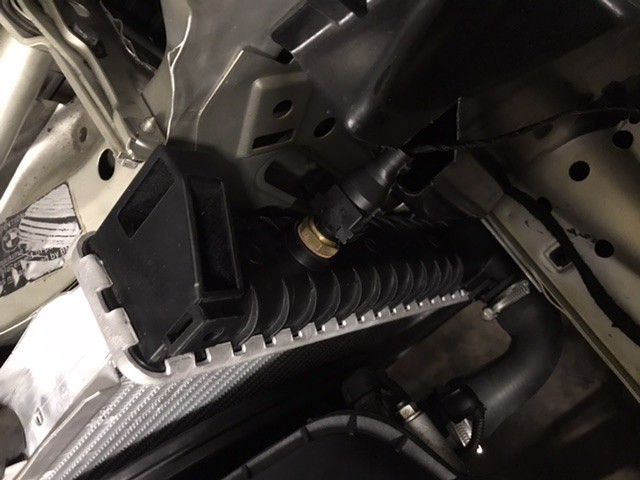

        Thanks for the responses. So I added the radiator outlet sensor to terminals 38 and 39 on the x60004. My question is does it matter if the sensor is threaded into the existing Upper port on the radiator instead of in the lower hose? I know it will be reading higher temps since it sits higher up. It was easier to mount it this way instead of having to find an adapter to fit on the lower hose. I have not run the car long enough to know if the fan kicks in but I hooked up an Autel scanner to it and the sensor was reading temps and no codes. I used an identical sensor to the one in the cylinder head. I also tried a different PWM and this one seems to work in that the fan does not come on when the battery is connected, so I am hoping it’s a working unit.

          Closest to the Rad outlet would be best. I brought my Aluminum rad to a welder, and for his minimum $40 he added and tapped a bung right below the outlet for me. I ended up not using it, but the current owner of my car could add the sensor if desired.
