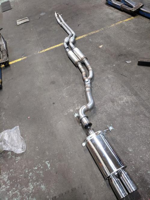

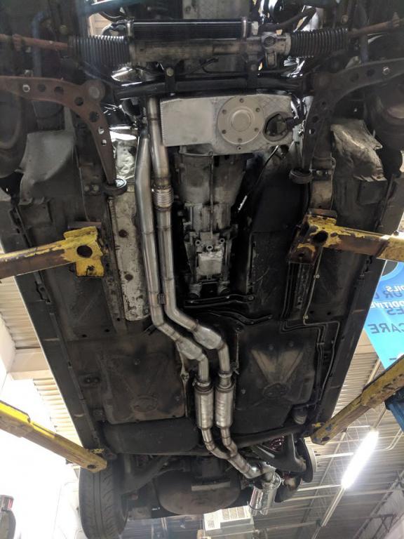

                    Originally posted by Staszek
                    Interested in hearing your setup.
                    I ran Stattus Groupe headers to E46 section one with N54 Cats, to a magnaflow X Pipe into an E36 M3 exhaust all 2.25. I wanted mine to be quiet and have no drone. Also the E36 Exhaust is heavy, couple that with the heavier battery I put in it helped me balance the weight out of the S54.
                    Anyway I dont really have a sound clip behind the exhaust but here is one from in the car.
                    https://www.youtube.com/watch?v=BBxf-1PoF0U
                    That actually sounds pretty good! No drone at all right? Do you have any photos of the exhaust layout?

                    • Staszek
                      • 2533
                      Awesome! Glad to see that you're making progress on this :)
                      Zero drone at all, I kinda do I added the x-pipe after these pics were taken, Take the pic below and add the x-pipe after the Cats and that is my current setup.

                        Wow that E36 muffler is massive, your car sounds really nice with that setup. I see that you were able to keep that underbody chassis brace with your setup. It looks like mine is not going to be able to fit with my setup.
                        • Staszek
                          • 2533
                          Yep, its not light, so its not the route to go for lightweight racer. The guy who did my exhaust setup actually mounted the E36 hangers to make it feel more OEM.
