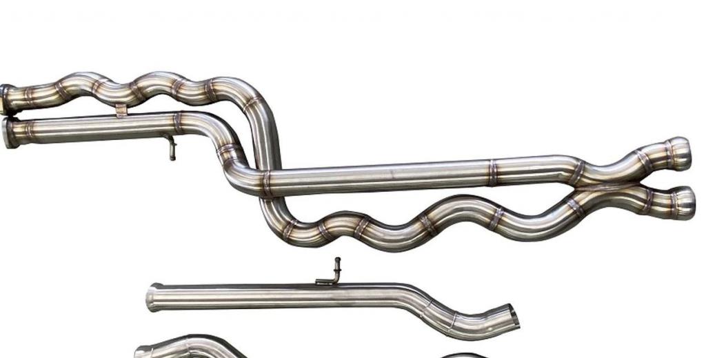

    1) This is Active Autowerkes equal length exhaust, the idea being that the rear bank is 1 foot closer to the merge so it's lengthened to make it equal.
    Thoughts?
    Relevance to DOHC e30's?
    Click image for larger version  Name:	Capture.JPG Views:	0 Size:	42.5 KB ID:	9961719
    2) I also see that one of the exhausts pictured above has a expansion bellow and the other one doesn't. Are they necessary?

      I did a below to ease alignment when installing the system. When I was welding it all up I knew that with the heat there would be SOME movement so the flexpipe just eases install when the system has to come down.
      Think about how the original M20 exhaust systems also had a flex in them on just one bank... I was following the same principal there.
      As for the active setup... the E46 M3 stuff doesn't quite fully bolt up to our cars so buying something like only to have to hack it up feels a bit foolish.
