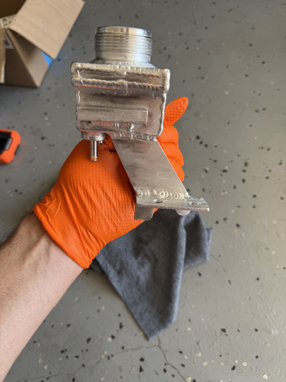

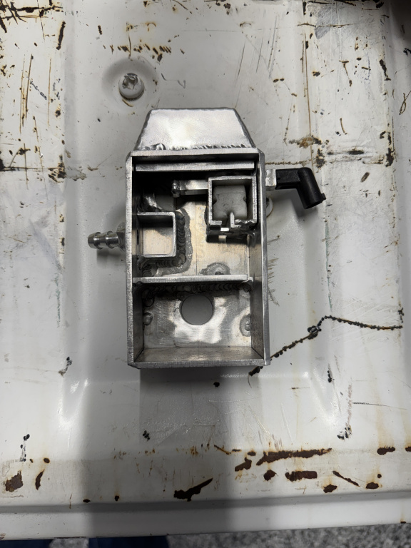

              #141

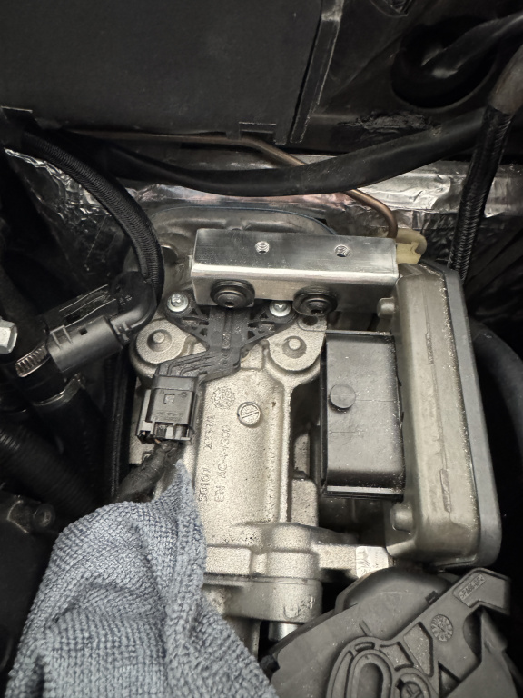

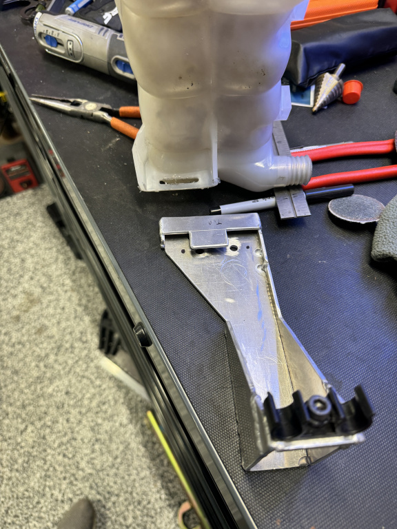

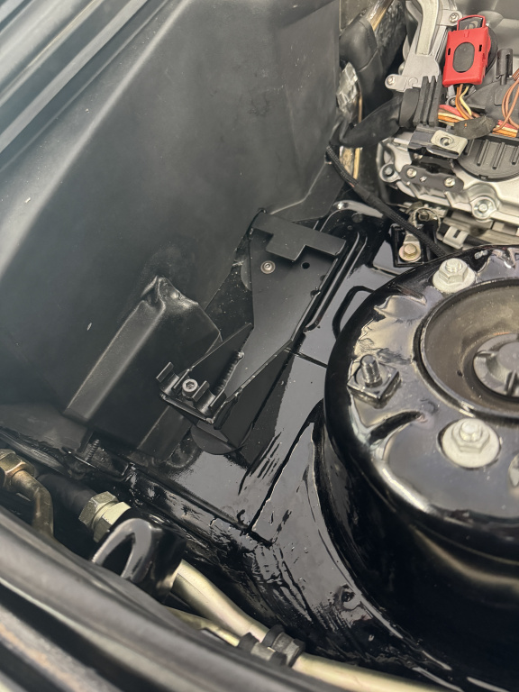

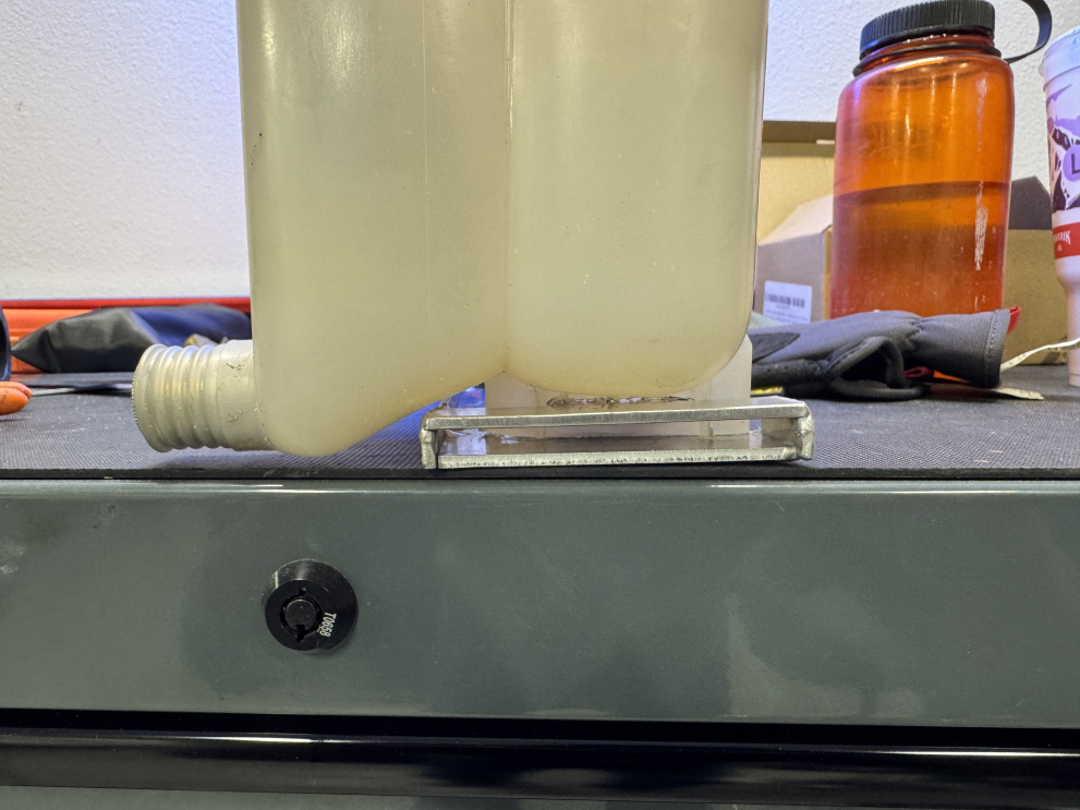

              The brake fluid reservoir sitting tilted forward and causing the fluid level light to flicker was irritating me so with my brother's welding help I finally came up with a solution.
              Here is version 1. It leaked from the 1mm walled square tube we used for the hall switch and the top didn't look great due to trying to keep heat down to keep from melting the float. I also had to mount it higher than the fuse box due to the location I chose for the AN fittings on bottom.
              Click image for larger version  Name:	IMG_1936 2.jpg Views:	0 Size:	172.0 KB ID:	10139830

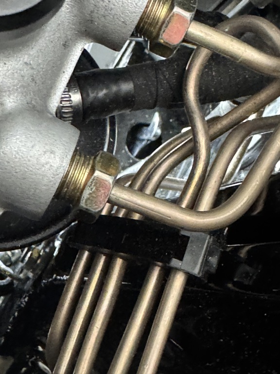

              Weird side track here. While installing this thing I found myself in about the most interesting predicament I've seen while working on this swap. I dropped a 10mm end wrench and it didn't hit the floor. Didn't think much of it until I went to put away my tools, just grabbed another one to finish up. Couldn't see it from up top so I lifted the car and searched around from the bottom side, still no luck. Finally after wedging my hand in the very crowded area of the frame rail I found it. I probably should've bought a lottery ticket after this, the odds of it dropping through this hole can't be very high. The picture doesn't due justice for how crowded this area is, to even get anything other than my finger tips on it I had to remove a bunch of stuff that was all installed prior to the engine!
              Click image for larger version  Name:	IMG_1984 2.jpg Views:	0 Size:	188.3 KB ID:	10139832
              After bumping it fully into the frame rail I made a trip to Ace for the smallest diameter magnet I could find and managed to snake it back out.
              Click image for larger version  Name:	IMG_1987 2.jpg Views:	0 Size:	217.4 KB ID:	10139833
              Back on track. Version 1 didn't work out so on to version 2. Re-designed so float could be installed after welding with sensor mounted to the outside. The switch will work with 1/8" aluminum between it and the magnet. Also put the clutch output on the bottom and moved all fittings outboard. Allowed this one to be mounted lower than the fuse box lid. It's baffled for each output so any one leak will only leak out to 1" above the bottom of the reservoir.
              Bonus, my brother was much happier with his welds on this one! Thanks dude!!
              Click image for larger version  Name:	IMG_1992 2.jpg Views:	0 Size:	173.2 KB ID:	10139831
              Click image for larger version  Name:	IMG_1991 2.jpg Views:	0 Size:	166.3 KB ID:	10139829
              • Striker01
                • Jul 2011
                • 379

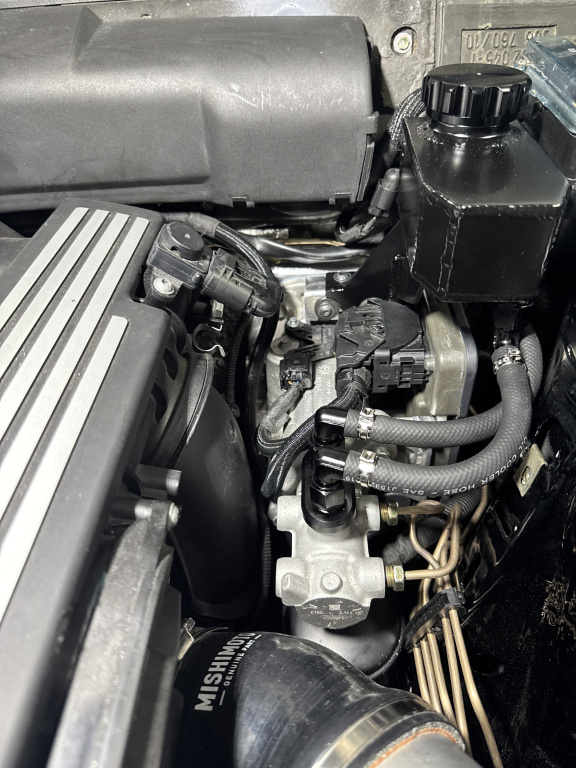

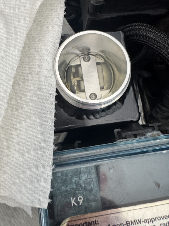

                #142
                Click image for larger version  Name:	IMG_1993 2.jpg Views:	0 Size:	138.6 KB ID:	10139838
                Made a shelf for it to sit and mounted it to the ibooster. Version 1 one was bolted straight to the booster and it was tricky to get installed.
                Click image for larger version  Name:	IMG_1989 2.jpg Views:	0 Size:	185.7 KB ID:	10139835
                Float switch works great!
                Click image for larger version  Name:	IMG_2002 2.jpg Views:	0 Size:	183.0 KB ID:	10139837
                Finished product.
                Click image for larger version  Name:	IMG_2009 2.jpg Views:	0 Size:	210.1 KB ID:	10139836
                Almost forgot. The piece that connects to the MC came from a company in the UK.
                Click image for larger version  Name:	IMG_1896.jpg Views:	0 Size:	172.9 KB ID:	10139839

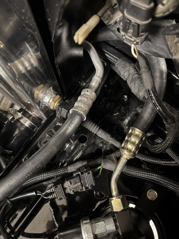

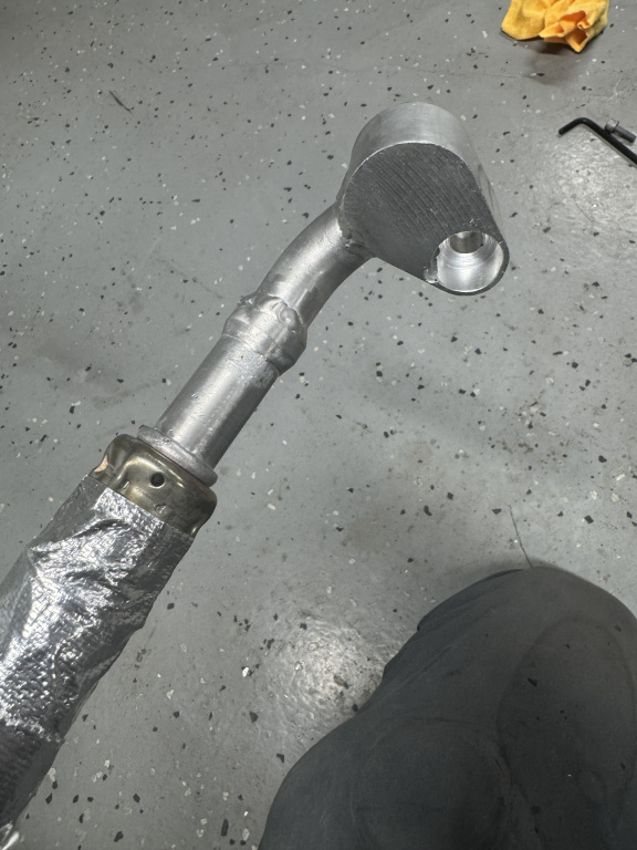

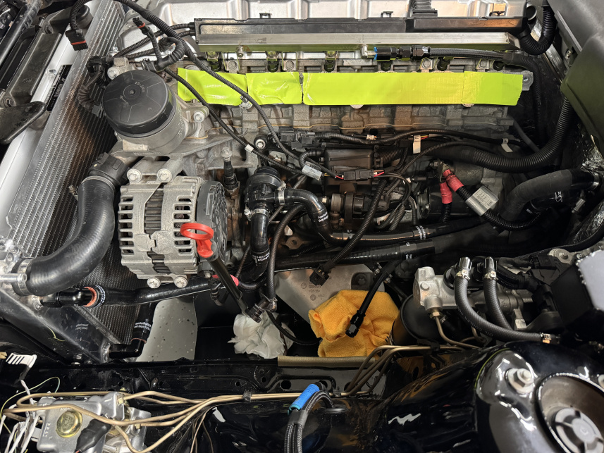

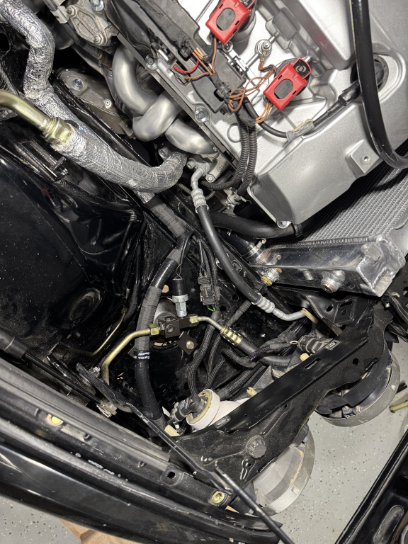

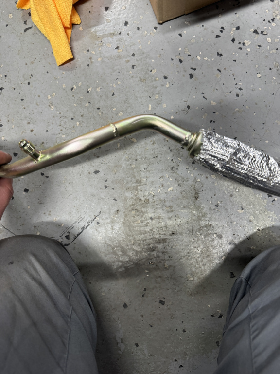

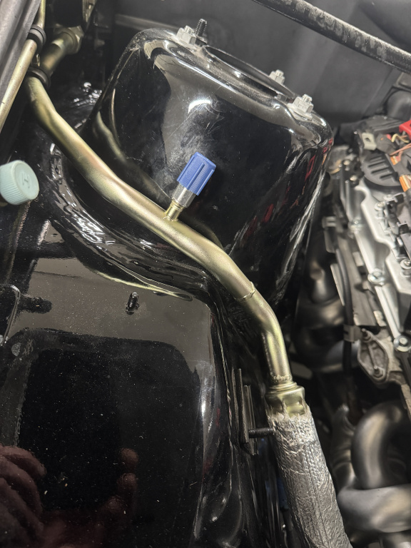

                      Now that the swap is running and I've put 600ish miles on it, it's time to get things exactly how I want them. Exhaust is hopefully on my final revision, details in the exhaust thread, I love how the N53 headers/supersprint s52 swap combo turned out. Cooling system is almost complete, the last silicone adapter I needed arrived today, I think! Just finished getting AC plumbed and it's holding vacuum.
                      I used a combination of Z4 stock compressor lines, new soft barrier hose and weld on hose barbs to mate with the E30 stuff.
                      Pressure side was relatively simple, cut the Z4 compressor fitting off, orient it as necessary and do the same on the e30 condenser side. I think we even used the Z4 soft line, I can't remember, so just 2 tiny welds for this hose. Added bonus the M20 hose used to rub on the frame rail, plenty of clearance with this one.
                      Low pressure side was a little more in-depth. Had to swap the orientation of the compressor fitting, changed from East-West to North-South and rotate the elbow. So a weld for the new orientation and one for the new barb. To switch the orientation I had to remove the locating pin from compressor. Getting it bolted on was not fun at all but possible.
                      E30 stock low side hose was re-oriented and the new barb welded on. New soft hose and some heat protection.
                      I had more pictures of the process but can't find them. Sorry guys.

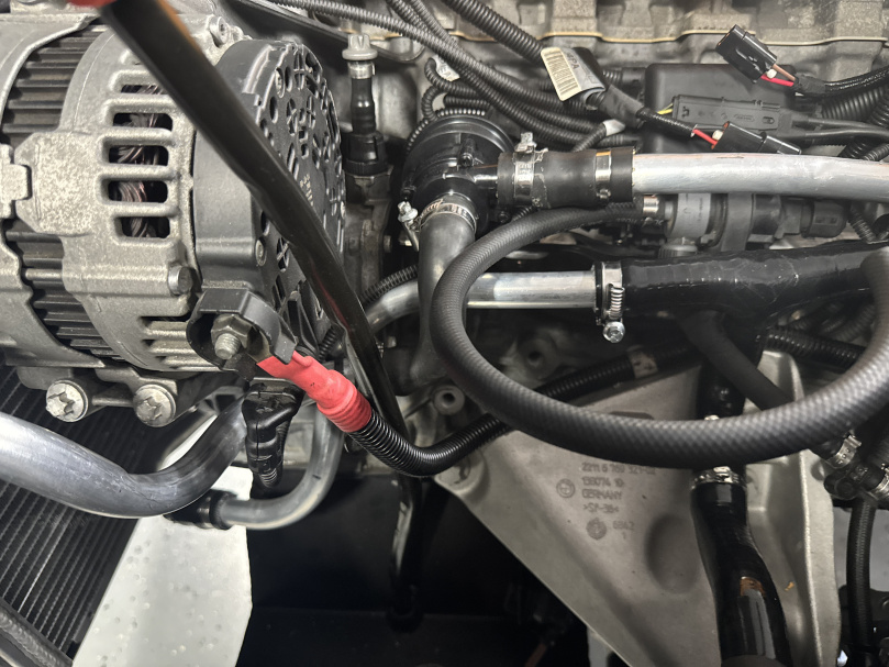

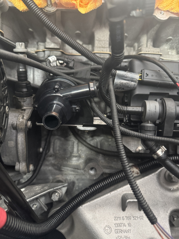

                        #146

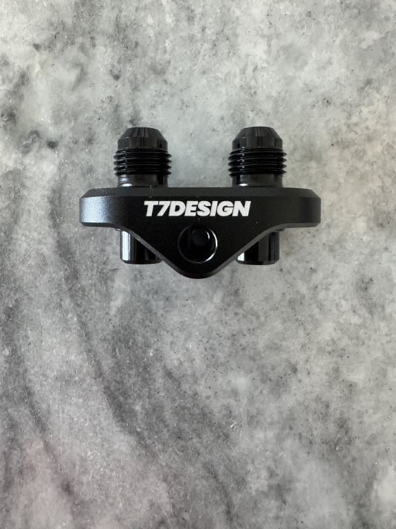

                        This post is another what not to do. Sometimes I should just settle with well enough!
                        With the electric water pump hoveringuy realized getting heat was a problem sometimes. The solution was to have the tune set to just run the water pump at 20% all the time. That solution works just fine but I wanted to let the ECU run the water pump as it pleases and add a small Aux pump for the heater core for the very few times I drive it when its cold. Hoveryinguy and adam.nonis were kind enough to share the M50 type intake manifold they came up with, with me. Huge thanks to Adam for building it!!
                        That manifold clears up a ton of real estate under the intake manifold so I decided to clean up some wiring, reroute heater stuff a little neater add an Aux pump. I mounted the "crab box" to the block with a bracket Adam designed then mounted an aux water pump to that. I thought thin walled aluminum tubing would be a good solution over rubber or silicone lines. Here's how it turned out.
                        Click image for larger version  Name:	IMG_2401.jpg Views:	0 Size:	217.6 KB ID:	10156173
                        Click image for larger version  Name:	IMG_2402.jpg Views:	0 Size:	195.4 KB ID:	10156174 Click image for larger version  Name:	IMG_2400.jpg Views:	0 Size:	181.7 KB ID:	10156175 Click image for larger version  Name:	IMG_2403.jpg Views:	0 Size:	213.2 KB ID:	10156176
                        This little pump is cool. Only draws 3 amps and is super quiet. It's relay controlled on when the heater core valve is open.
                        Click image for larger version  Name:	IMG_2379.jpg Views:	0 Size:	177.3 KB ID:	10156178
                        I thought all was well until I drove in cold weather. I got heat without issue but started getting codes for intake air temps. After a drive I parked in the garage and the car idled for maybe 10 minutes while I hooked up INPA and checked for codes. The IAT code was back so I opened the hood a realized that my temps on the intake side were insane. The high temp resin intake manifold was so hot it felt malleable and I couldn't put my hand on the aluminum intake tube. The stock runner part of the intake was hot but not like the stuff further from the engine.
                        At the same time I changed the intake and heater plumbing I'd also gotten my new headers back from coating and didn't know where to start. I ended up bore scoping the headers, cats looked brand new so no clog there, also the car ran fine so I didn't really think that was the issue.
                        The only thing that I can figure is that the aux pump moved enough water through the heater core that the radiator wasn't doing anything, all that heat was radiating off those thin aluminum pipes and cooking everything on the intake side. My coolant gauge was normal and the aux fan never kicked on.

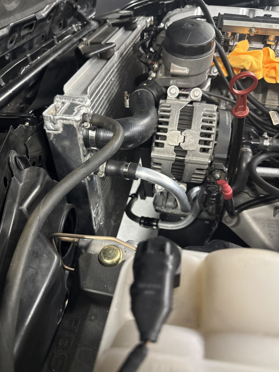

                          I could've just converted back to how I had is setup before but that wouldn't be any fun and I didn't like the silicone hose crossing under the radiator so back to the drawing board.
                          My radiator had a pin hole from one of my "upgrades" so decided to just redo it all, this time with all silicone hoses and AN10 fittings for the heater core. With the Aux pump there is no need for the expansion tank to be on the driver's side anymore. I have the heater plumbed on a closed loop to the hot side of the radiator, so the radiator can still operate as intended; heater on or off. The expansion tank will fit in the battery tray, just has to be shortened a bit to clear the hood.

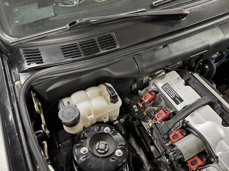

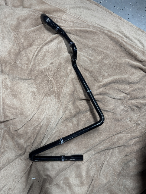

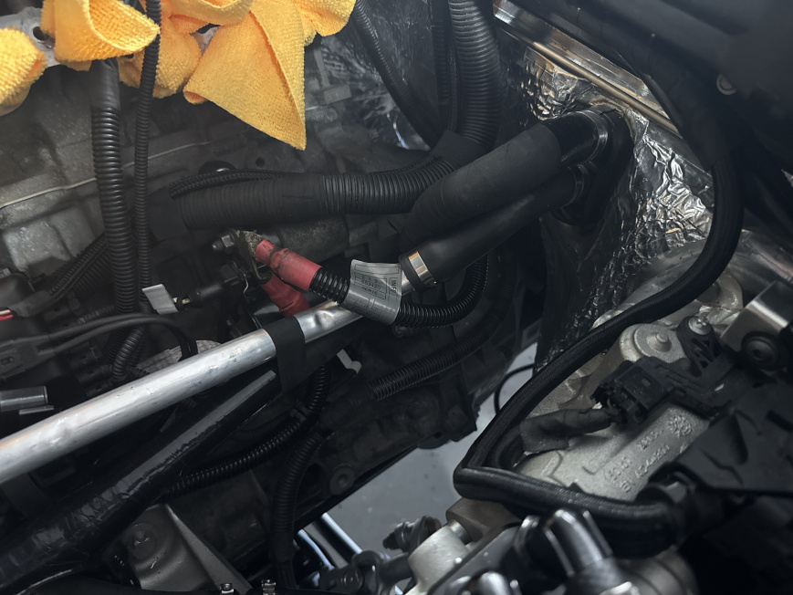

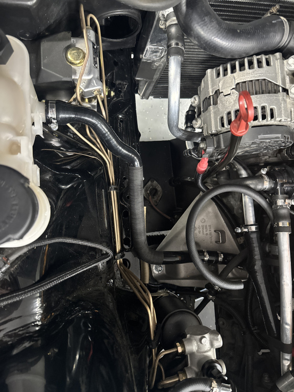

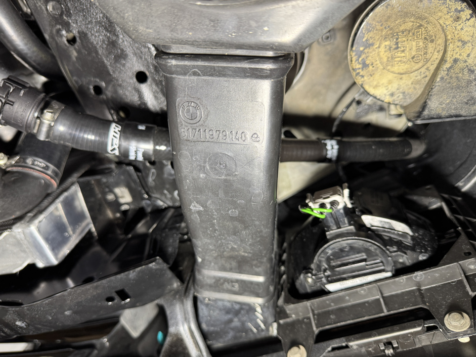

                            To prevent tons of worm clamps I decided to try out gates heat shrink hose clamps, remains to be seen how they work out. I tried to use pre-made bends wherever possible.
                            New plan for driver's side, no more super conducting aluminum and hoses further from intake tubing.
                            This crazy looking piece goes from the expansion tank to the thermostat housing.
                            Installed
                            Just need to finish up the small overflow hose and hopefully good to go.
                            • hoveringuy
                              • Dec 2005
                              • 2745
                              #149
                              Originally posted by Striker01
                              Installed
                              This concept has been on my to-do list for a while... hard to find clean routing on that side with the exhaust.
                              • Striker01
                                • Jul 2011
                                • 379
                                #150
                                I reduced from the 1” overflow tank outlet down to 1/2” until right before the thermostat housing. Silicone hose is rated to like 300f. Should be good with the insulated wrap. I hope!
