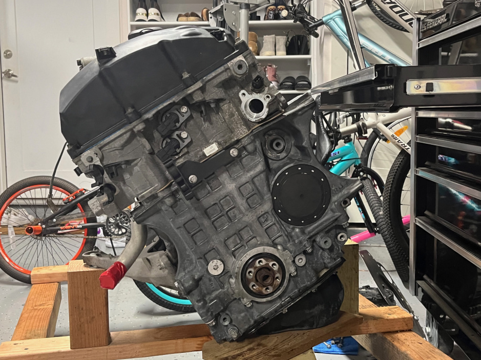

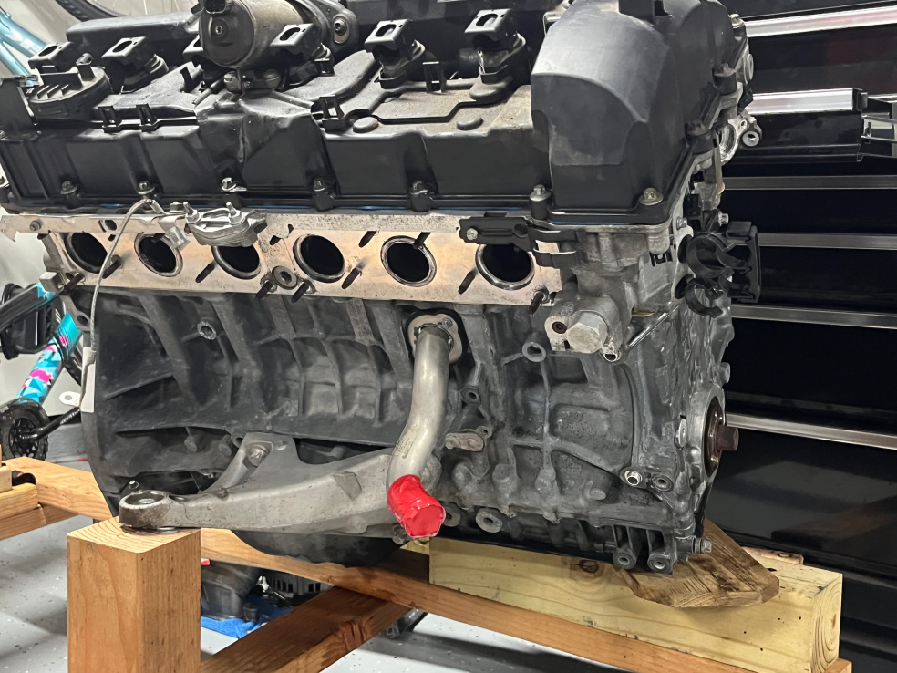

            I made a little progress this weekend. Built a stand to hold the N52 while I clean it up and prep it and got the underside stuff out of the way so I can pull the M20. My brother helped label the harness, what we could figure out anyway, and pulled that off.
Name:	N52 wood stand.jpg

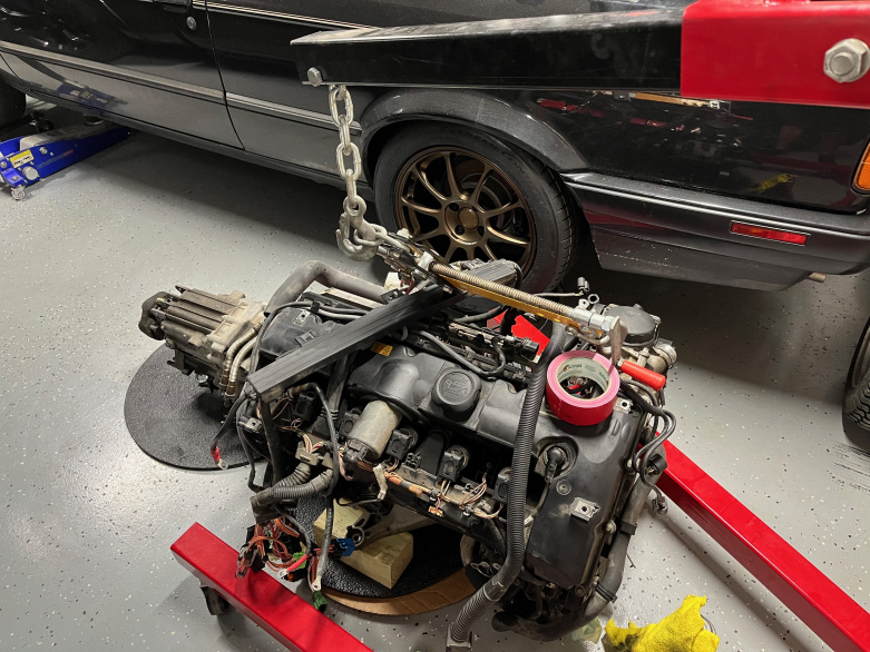

              Slowly but surely making progress. Got the N52 stripped down and cleaned up, just waiting on parts for it now.
              Click image for larger version  Name:	IMG_0909.jpg Views:	0 Size:	320.6 KB ID:	10103954

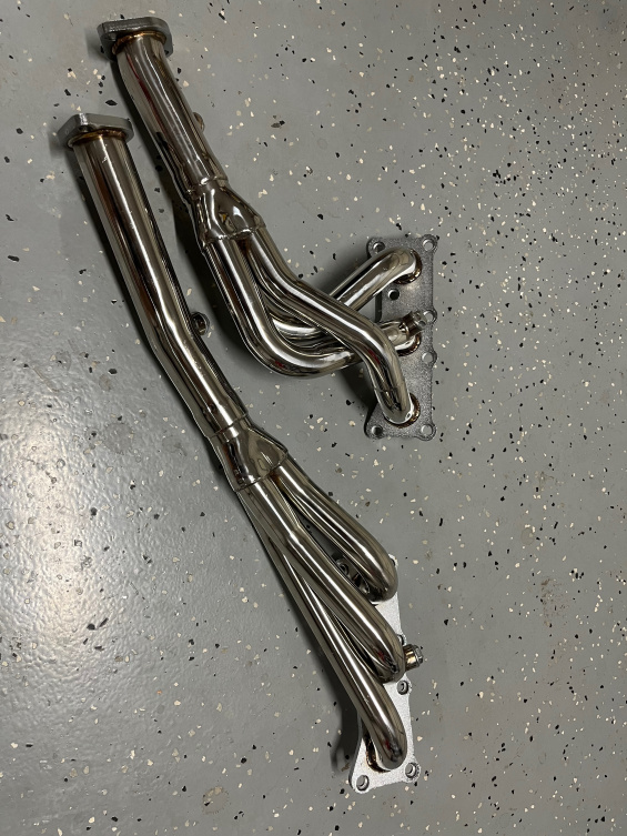

              My headers arrived from Poland, weird they were faster than stuff I order from some places here in the states. The OD of the headers is 2" at the flange so I think I'll just try to run my Stromung M20 exhaust to get started, it's 1 7/8 OD, and just have to build a center section with new cats.
              Click image for larger version  Name:	IMG_0915.jpg Views:	0 Size:	221.9 KB ID:	10103955

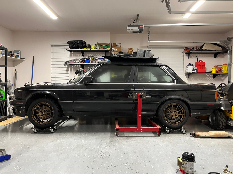

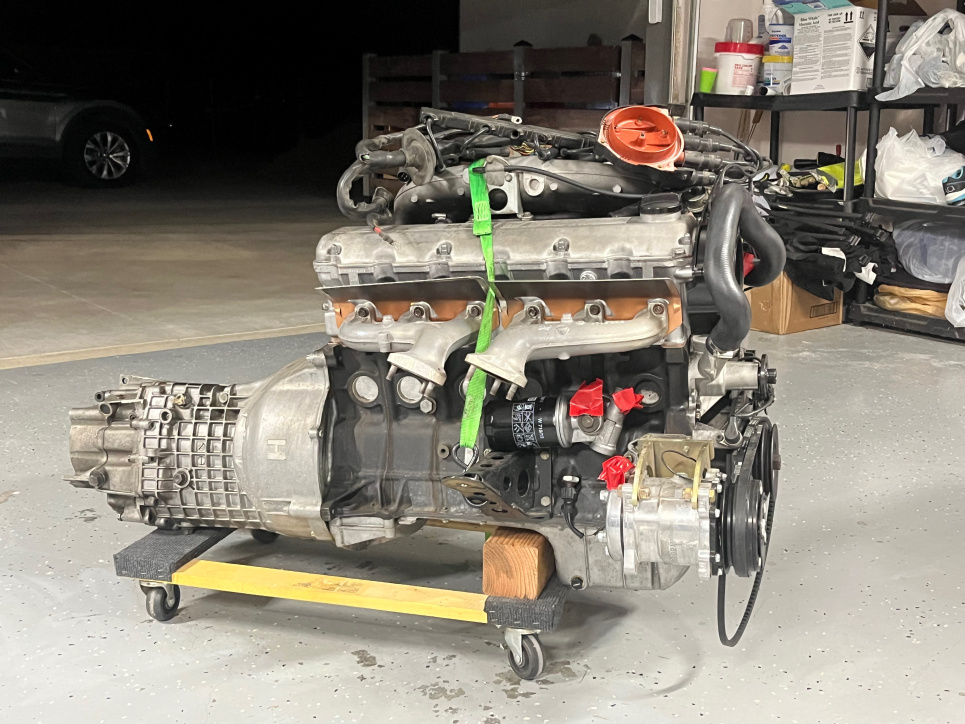

              The M20 is out of the car, hopefully I can sell some of the stuff off of it to fund a small portion of this swap.
              Click image for larger version  Name:	IMG_0906.jpg Views:	0 Size:	303.1 KB ID:	10103951

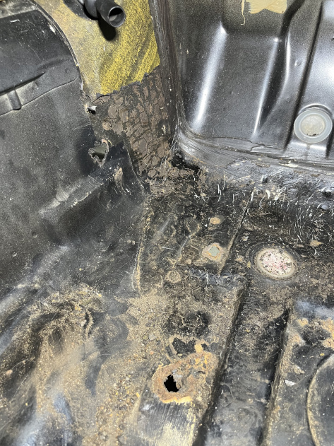

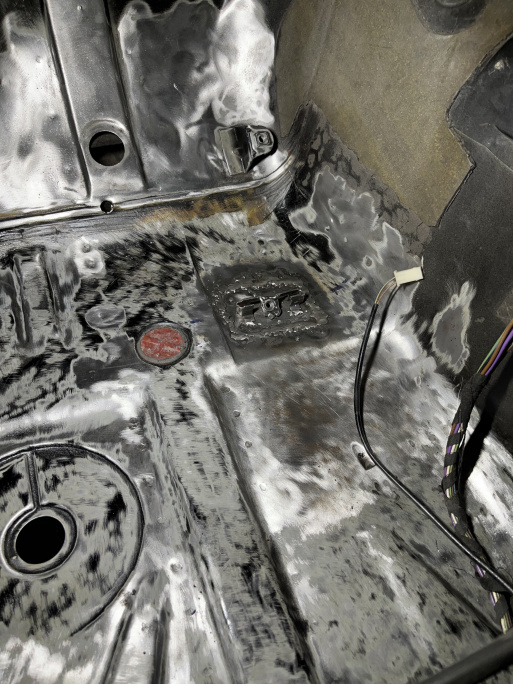

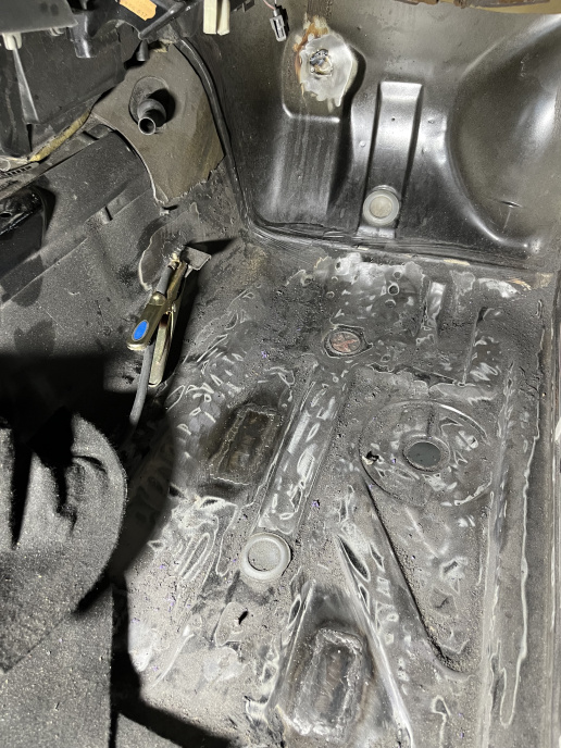

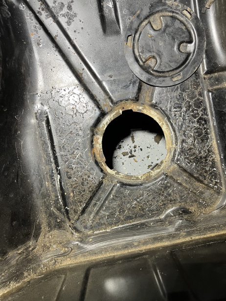

                I pulled up the carpet on the driver's side to weld in a nut for the e90 pedal and found some rust. Because I'm unable to leave well enough alone and just fix around the pedal and move on, I decided to pull the carpet and see how much more there is. Not my brightest moment I guess. Found a bunch more, especially on the passenger side. I guess the swap will have to wait a couple weeks while I fix the holy floor.
                I know I'm not going back with that thick rubber firewall insulation, it was rusted through on a few of the studs for those plastic nuts.
                Do you guys see any issue with permanently sealing up these giant plugs that were loose despite the seam sealer?

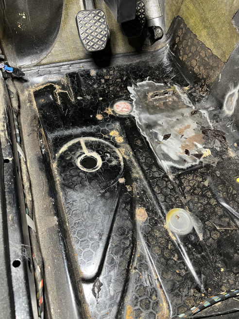

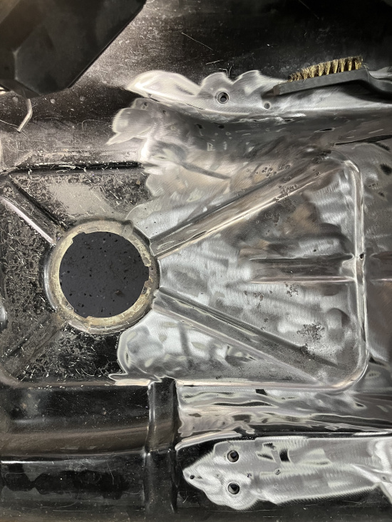

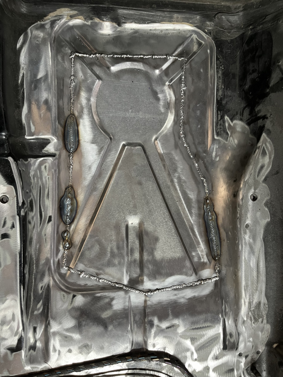

                        Got a few holes repaired and the pedal mount ready for the new pedal. I suck at welding but the floor is a good place to practice I guess.
                        Click image for larger version  Name:	IMG_1069.jpg Views:	0 Size:	197.4 KB ID:	10105784
                        Click image for larger version  Name:	IMG_1070.jpg Views:	0 Size:	206.7 KB ID:	10105783

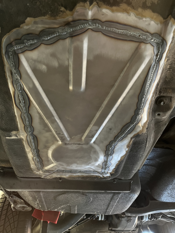

                        This area looks like a lot of work to patch so I ordered a right rear floor pan replacement piece. Waiting for that to arrive.
                        Click image for larger version  Name:	IMG_1071.jpg Views:	0 Size:	211.1 KB ID:	10105785

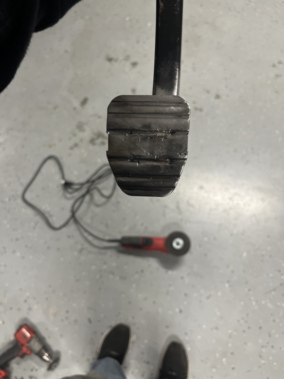

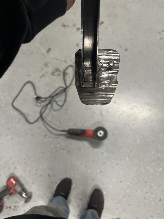

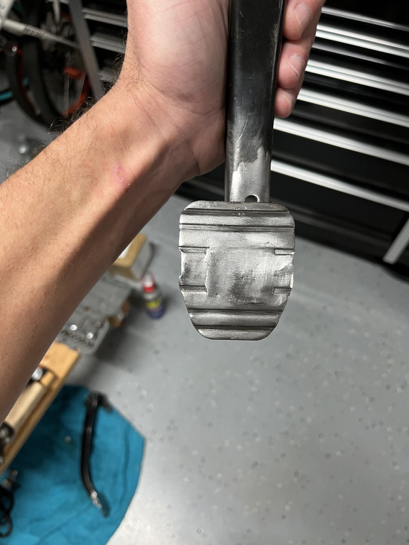

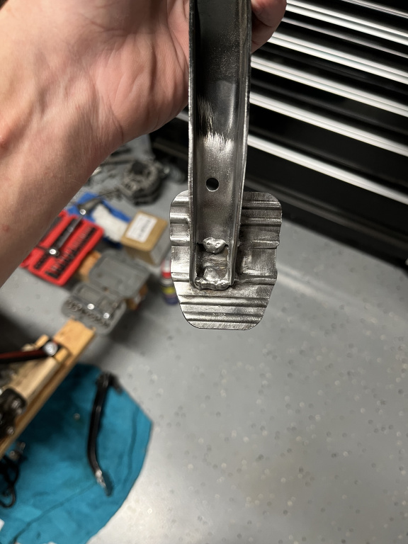

                          Decided to move the brake and clutch pedal pads left a 1/4" or so, tired of dragging my foot on the brake pedal when using the gas.
                          Click image for larger version  Name:	71894691423__65A323A3-3602-492E-BD75-3AEFB4125B74.jpg Views:	0 Size:	96.1 KB ID:	10105787
                          Click image for larger version  Name:	71894690454__8C8E6B5E-398E-4EA1-9053-A898129B5D21.jpg Views:	0 Size:	105.2 KB ID:	10105788
                          Click image for larger version  Name:	IMG_1076.jpg Views:	0 Size:	144.7 KB ID:	10105789
                          Click image for larger version  Name:	IMG_1077.jpg Views:	0 Size:	147.7 KB ID:	10105790

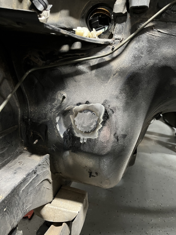

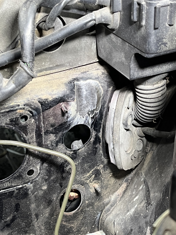

                            Been getting a little done on the car. I think I'm finished with floor and firewall repairs. I don't want to mess with the engine bay until after I get the engine test fitted to figure out exhaust clearance and driveshaft. I didn't get the replacement floor plate perfect but it's better than a rust perforated one. Finally getting the welder to cooperate with me a little better.
                            Click image for larger version  Name:	IMG_1094.jpg Views:	0 Size:	225.8 KB ID:	10107149
                            Click image for larger version  Name:	IMG_1093 2.jpg Views:	0 Size:	182.1 KB ID:	10107148
                            Click image for larger version  Name:	IMG_1067 2.jpg Views:	0 Size:	197.7 KB ID:	10107150
                            No turning back now, throttle cable hole is plugged.

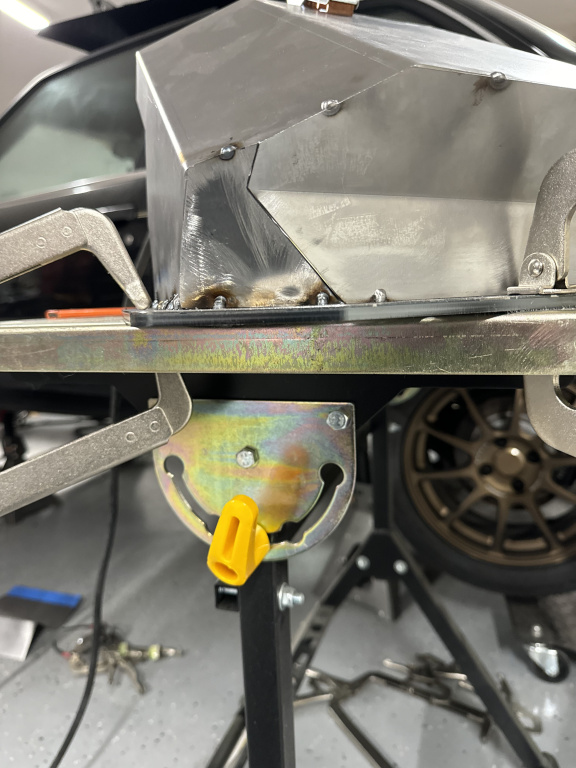

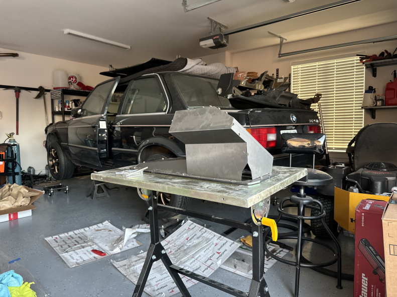

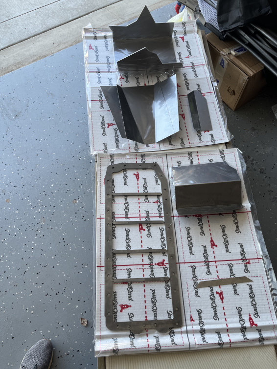

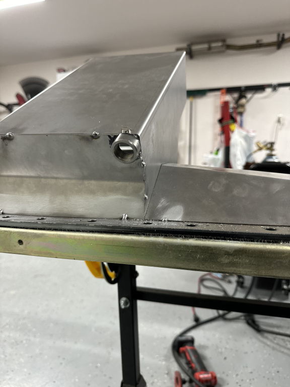

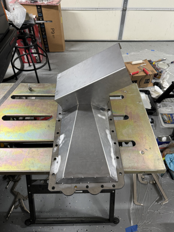

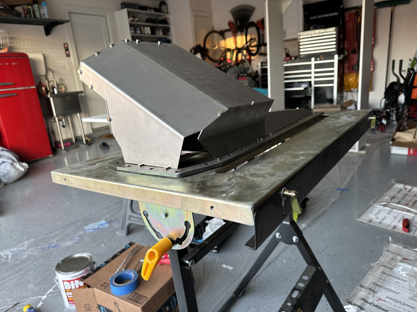

                              Tired of working on rust repair stuff so decided to attempt to get this oil pan put together. Thanks again to hoveringuy, amazing work on the pan design and offering lots of pointers along the way. I also stole his small magnet idea to mock it up.
                              I just need my brother to get moved into his house so he can pull his TIG machine out of storage and get this thing welded up.
