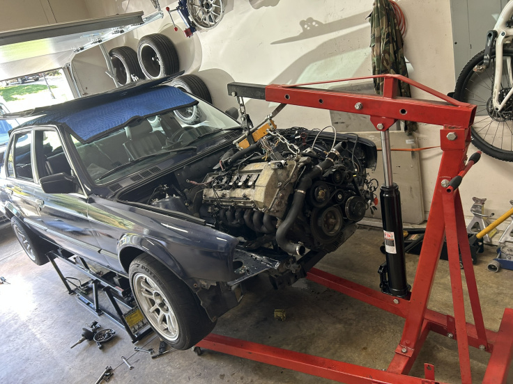

    Hello all! I was initially intrigued by Garageaholic YouTube E30 / N54 build series and then found and was inspired by this subforum. The plan is to perform E30 / N52 swap with focus on track toy / mountain road cruising / maybe hill climbs. Hope this crew of intelligent DIY'ers will keep me pointed in right direction! I've read through and taken notes on most of the major build threads but I'm surely going to miss something... or some aspect of the swap will have evolved.
    I'm drawn to the N52 for same reasons as most... weight vs. power / torque... and it will fit nicely in SCCA Time Trial "Max 5" class. My E30 already has AC and Cruise Control removed... but heat and power steering must stay.
    Similar to others, I am starting out with Z4 engine mounts. Evaluating custom subframe vs. custom oil pan. Keeping both options open at moment but leaning toward custom steel oil pan and SendCutSend parts have been ordered. MIG welding is not an issue but not yet proficient with TIG.
    I've been thinking about this swap for awhile and last year I acquired an E90 with rear-end damage. Already pulled engine, harness, manual transmission, DME, pedal, CAS, key Fob, fan, brake booster, and misc other parts. A notable difference on this swap is that I'll be using E90 N52 from 2011. This means MSV80. (Current) plan is to use pre-made engine --> chassis harness with CAN emulator... with the intent of making everything "plug and play".
    Phase 1 will start with N52 installation and getting the car up and running on stock DME with stock intake manifold. Hopefully we'll get to Phase 2 of increasing power!​

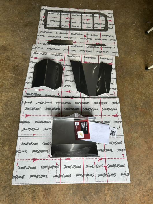

              Update:
              M50 is out!
              SCS steel oil pan pieces have arrived. Planning to use hoveringuy 3D printed Al oil pick-up.
              Striker exhaust system purchased and received. (Thank you!)
              Next-up is to preliminary install of N52 and confirm plan for driveshaft, shift linkage, brake booster clearance.
              Currently planning to use Mishimoto radiator, pusher fan, and stock E30 overflow tank. (Unless someone has better suggestion.)

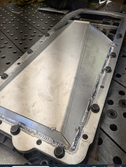

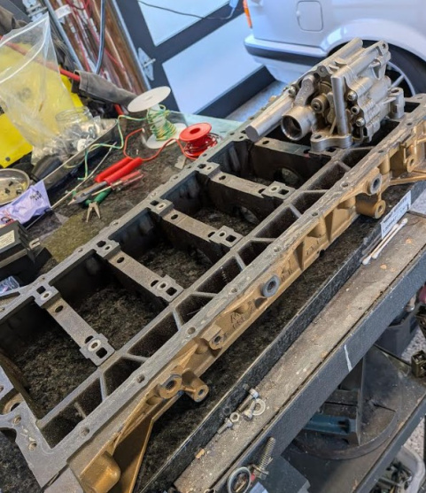

                Cool! I highly recommend that you pick-up a bedplate to fabricate the pan, even better if you get it with an oil pump. You can bolt the flange to it and keep everything flat and tidy. Also Tig>Mig. It's not too tough to get a nice bead on clean steel but find someone that's got a decent rig and some experience if you don't.
                Those cross-braces will also help keep the flange from pulling in while welding.

                • Disterber
                  • Sep 2023
                  • 22
                  Great point on the bedplate. I already started welding. Initially, I laid down just a few short stitch welds (without bedplate) and the entire flange warped almost immediately. I received bedplate last week and started over. Bedplate made HUGE difference. Essentially no warpage. I am using MIG with small stitch welds. Definitely not the prettiest and filling in pinhole porosity might be tedious. My plan is to pressure test pan and check for leaks with soapy water. Will post progress.
                  In summary, bedplate is a must!
