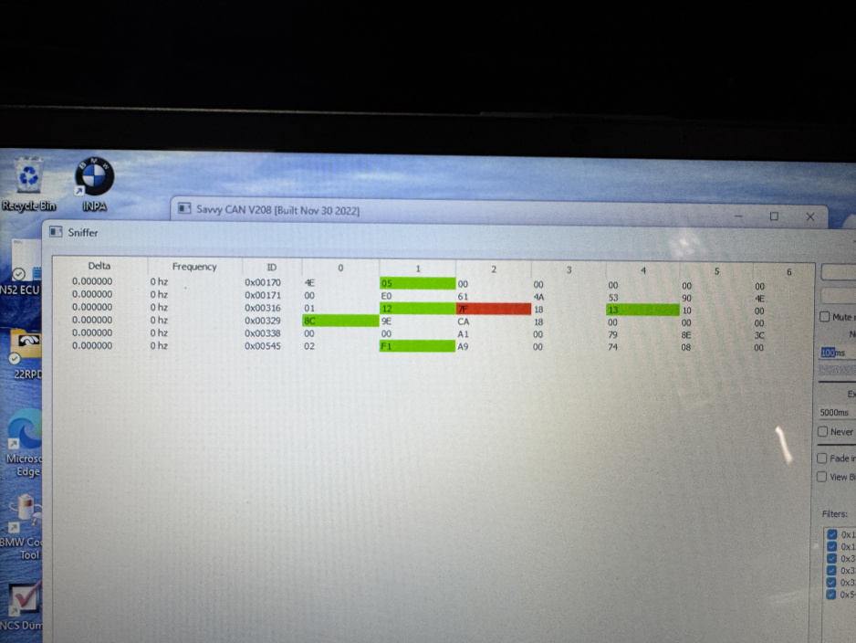

    Here is what I see with Savvycan and just the ECU and EKP on the CAN network.
    Click image for larger version  Name:	IMG_2606.jpg Views:	0 Size:	194.0 KB ID:	10153446
    I have verified that 0x00545 byte 0 is for the CEL, bit 1 is emissions light and 4 is EML. So by monitoring for HEX 10, 02, or 12 on byte 0 we should be able to power on a CEL. Byte 3 bit 3 (08 HEX) is supposed to be an overheat indication, I need to hook up a variable resistor to test that one.
    I have an arduino and sketch written to monitor the bus but can't get it to work. It is wired according to the arduino documentation. I have some hardware hoveringuy recommended on the way to try.
    The sketch is written to turn off the LED when those messages are present, just to verify the board is actually working. The LED comes on with power up but I'm still trying to figure out if its actually listening to the bus. If any of you guys are familiar will you look over my sketch and make sure it is correct, I used AI to write it.

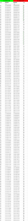

    For the AC I managed to isolate the bit that signals the "aircon input request" in INPA, idle jumps up when it happens so that is a positive sign! 0x00615 byte 0 Hex 80 from the above link doesn't work for me.
    Click image for larger version  Name:	IMG_2627.jpg Views:	0 Size:	173.6 KB ID:	10153447
    I used the Savvycan send frame function to try every HEX combination on 0x00615 byte 0 to figure out which bit signals the ECU. Bit 7 @ 1 turns it on. Here is the table:
    AC INPUT ON AC INPUT OFF

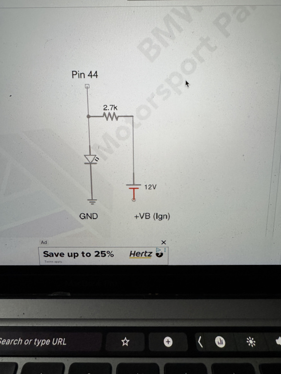

              Re-visiting this now that I have cleaned up a bunch of stuff on the car that I wanted to change once it was up and running.
              I think I have successfully gotten a micro-controller to control the CEL.
              I wired an LED into the original E30 circuit with a resistor to reduce the voltage and act as a pull up circuit. The light is on until the microcontroller output is LOW. Here is a borrowed picture from an MK60 resource. Instead of Pin 44, I have it connected to PIN5 of my adafruit RP2040 with CAN. I don't remember what resistor value I used but there are calculators online, the value is based off of LED max voltage, current draw and the 12v source. I think I doubled the minimum requirement.
              According to the MS43 wiki page 0x545 byte 1 bit 1 and 4 are for CEL and Emission issues. Byte 3 bit 3 is for an overheat indication.
              The CEL now comes on for 3 seconds, switches off and comes back on with ignition. That is expected as byte 0 is 12 until the engine is started, after start it goes 00 and the CEL goes out.
              I don't know how often the ECU checks the status of all the engine sensors but I can see errors in INPA before the CEL comes on. Confirmed I have DTCs that should bring on the CEL but 0x545 still transmits 00 for byte 0 for a while, not sure why. Eventually the message updates and my CEL comes on. I think the ECU will probably update earlier if the issue is severe enough. I tested by unplugging the MAF and MAP, neither turned it on immediately.
