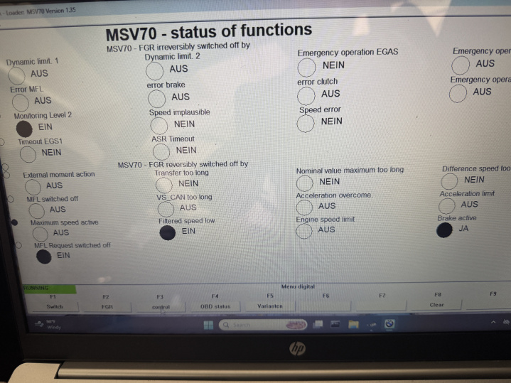

                My current issue:
                Cruise stalk won't do anything, the 3 blocks listed below never clear:
                FGR on the control page(MSV - Status of Functions): MFL Request switched off - EIN, Filtered speed low -EIN, and Brake Active - JA.

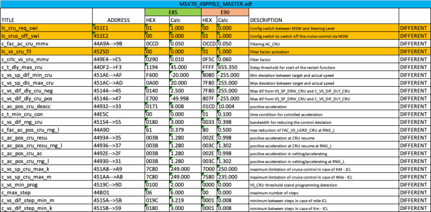

                MFL Request: I'm fairly certain my tune is a version of an e90 so I compared an e90 .bin to an e85 .bin. Searching _cru in tunerpro I found 24 differences. The ones in orange I figured are probably most important and hoped the first one would clear out that block.
                MSV70_49PP0LS_MASTER.xdf
                TITLE ADDRESS E85 E90 DESCRIPTION
                HEX Calc HEX Calc
                lc_cru_req_swi 451E1 01 1.000 00 0.000 Config switch between MSW and Steering Lever DIFFERENT
                lc_crus_off_swi 451E2 00 0.000 01 1.000 Config switch to switch off the cruise control via MSW DIFFERENT
                c_fac_ac_cru_mmv 44A9A-->9B 0CCD 0.050 OCCD 0.050 Filtering AC_CRU DIFFERENT
                lc_vs_cru_fil 4525D 00 0.000 01 1.000 Filter factor activation DIFFERENT
                c_crlc_vs_cru_mmv 449E4-->E5 0290 0.010 0F5C 0.060 Filter factor DIFFERENT
                c_t_dly_max_cru 44DF2-->F3 1194 45.000 FFFF 655.350 Delay threshold for start of the restart function DIFFERENT
                c_vs_sp_dif_min_cru 451AE-->AF F600 -20.000 8080 -255.000 Min deviation between target and actual speed DIFFERENT
                c_vs_sp_dis_max_cru 451AC-->AD 0A00 20.000 7F80 255.000 Max deviation between target and actual speed DIFFERENT
                c_vs_dif_dly_cru_neg 45144-->45 0140 2.500 7F80 255.000 Max dif from VS_SP_DRIV_CRU and C_VS_DIF_DLY_CRU DIFFERENT
                c_vs_dif_dly_cru_pos 45146-->47 E700 -49.998 807F -255.000 Max dif from VS_SP_DRIV_CRU and C_VS_DIF_DLY_CRU DIFFERENT
                c_ac_pos_cru_deacc 44932-->33 0171 8.008 01CD 10.004 positive acceleration DIFFERENT
                c_t_min_cru_con 44E5C 00 0.000 01 0.100 time condition for cotrolled acceleration DIFFERENT
                c_vs_dif_rng_cru 45154-->55 0180 3.000 0033 0.398 bandwidth for reducing the control deviation DIFFERENT
                c_fac_ac_pos_cru_rng_l 44A9D 61 0.379 80 0.500 max reduction of FAC_VS_LGRD_CRU at RNG_L DIFFERENT
                c_ac_pos_cru_resu 44934-->35 003B 1.280 002E 0.998 positive acceleration at CRU resume DIFFERENT
                c_ac_pos_cru_resu_rng_l 44936-->37 003B 1.280 003C 1.302 positive acceleration at CRU resume at RNG_L DIFFERENT
                c_ac_pos_cru_ac 4492E-->2F 003B 1.280 002E 0.998 positive acceleration in setting/accelerating DIFFERENT
                c_ac_pos_cru_rng_l 44930-->31 003B 1.280 003C 1.302 positive acceleration in setting/accelerating at RNG_L DIFFERENT
                c_vs_sp_cru_max_k 451A8-->A9 7C80 249.000 7D00 250.000 maximum limitation of cruise control in case of KM - ICL DIFFERENT
                c_vs_sp_cru_max_m 451AA-->AB 7C80 249.000 7580 235.000 maximum limitation of cruise control in case of Mile - ICL DIFFERENT
                c_vs_min_prog 4519C-->9D 0100 2.000 0000 0.000 VS_CRU threshold stand programming detection DIFFERENT
                c_max_step 44BD1 06 6.000 00 0.000 maximum number of steps DIFFERENT
                c_vs_dif_step_min_m 4515A-->5B 019C 3.219 0001 0.008 minimum between steps in case of mile ICL DIFFERENT
                c_vs_dif_step_min_k 45158-->59 0180 3.000 0001 0.008 minimum between steps in case of Km - ICL DIFFERENT
                I had the orange three changed to match e85 but the MFL error won't go away, I can clear the control page and it's back when I start the car again.
                Filtered speed low - EIN: This never clears, even when INPA shows above 60kph. If anyone knows what MSV70 needs to filter the speed please let me know!!!! Is it latched until the MFL request changes?
                Brake Active - JA: This one is off when I start the car, as soon as I touch the brake it comes on and stays on. Again, is it latched until the cruise is requested on or filtered speed is clear?
                The only change I've noticed since updating those 3 bytes is that if I attempt to turn on with the stalk and press forward to accelerate, the car throttle will surge for maybe .5 seconds before it cuts out and Monitoring Level 2 (irreversibly switched off error) comes on with DTC: 2D50 - Interner Fehler: Überwachung Fahrgeschwindigkeit.
                Someone pleas help!!! I'm stuck!
