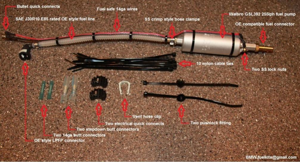

                The lpfp is the in tank fuel pump that the e30 community will eat alive, with a DIY it will be cheap.
                It's just a regular walbro that we are used to seeing but in a casing.
                Here's another example of steveAZ from fuel-it! It's an older DIY but it shows the simplicity none the less.
