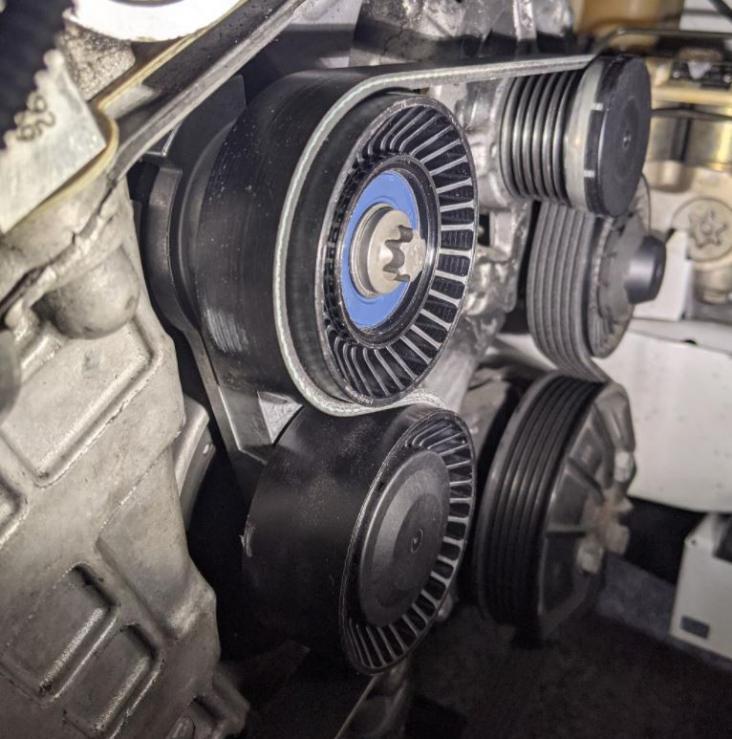

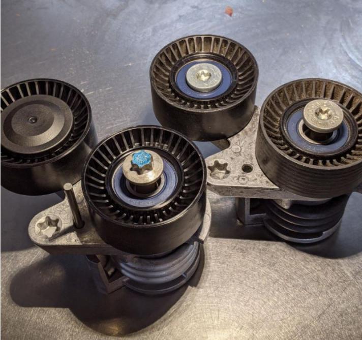

      This is hopefully the last post from me on the belt tensioners.
      One niggling issue I had when I installed the N54 tensioner is that the belt doesn't appear centered on the pulley, there's a solid 7mm space between the belt and the end of the pulley that makes it look like the belt isn't centered, and that made me concerned that there was a difference in backspacing between the N54 and the X5 tensioners.
      Click image for larger version  Name:	Capture.JPG Views:	0 Size:	72.8 KB ID:	9974797
      So, I did the rational thing and ordered a genuine X5 tensioner, P/N 11-28-7-565-225. The only differences between the N54 tensioner, P/N 11-28-7-563-927 and the X5 one is that the former comes with a steel bolt and the latter an aluminum bolt. Also, it seems that all instances of N52 tensioners have silver tension springs instead of black. Different steel composition or just paint... I dunno. Otherwise, everything else between them was identical.
      E70 X5 on the left and N54 on the right
      Click image for larger version  Name:	Capture2.JPG Views:	0 Size:	71.1 KB ID:	9974796
      I also discovered why my belt looked so cattywampus on the N54 tensioner: the pulley is physically thicker. The N54-style tensioner has a 30mm thick pulley whereas the normal N52 one is only 26mm AND any N54 or N52 with that style tensioner has a 7 rib K07 belt instead of a 6 rib K06 belt!
      I tried mounting a set of 26mm pulleys on the N54 tensioner but that legitimately screws things up because it changes the pulley centerline.
      Notice that the backs of the pulleys are perfectly aligned.
      Click image for larger version  Name:	Capture3.JPG Views:	0 Size:	113.8 KB ID:	9974795
      Bottom line.
      The N54-style tensioner works just fine. You can either order the cheaper N54 tensioner ($65) and then order the aluminum M11x99 bolt that goes with it separately ($15) or just order the X5 tensioner for around $140.
      Sorted.

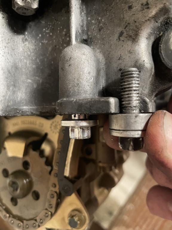

        While I'm thinking about it and because there's no better place to put it (although I'm sure I've rambled about this... it only became relevant right now)
        There are two kinds of N52 oil pan bolts. The one on the left is for the aluminum (thick flange) automatic pan. The one on the right is for the steel (thin flange) manual pan. The bolts are identical length, but the steel pan bolt has a captive spacer so the bolt "behaves" the same way when tensioned. The challenge here is that the auto pan "kit" has some longer bolts for... whatever the auto pan looks like.
        To get enough of the no-spacer bolts, we ended up buying two auto kits each.
        The reason this is important? If you order bolts for a manual transmission because you have a manual transmission, you’ll probably pull the threads out of the bottom of the block because your bolts won’t have enough embedment.
        Click image for larger version  Name:	File_005.jpeg Views:	0 Size:	59.0 KB ID:	9974814

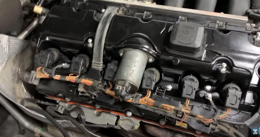

              Magnesium and plastic valve covers have exclusive ignition/injection wiring harnesses. The magnesium valve cover has a long tray that fits nicely:
              In this harness, the umbilical from the DME enters between cyl 4&5, and then the injection wiring is routed around the back of the engine to the injector rail. The plastic valve cover harness management is shorter, and doesn't fit around the bosses on the mag:
              This is a screenshot from a plastic to mag cover conversion video here: https://www.youtube.com/watch?v=5uedpKybBEw&t=1835s and please ignore that the cover is black... he painted it black. that's magnesium. the other thing you notice here is that the wiring crosses over the top of the valve cover instead of looping around the back, and the umbilical *enters* from the back corner. There may be more permutations resulting in even more harness detailing, because the exit location of the umbilical is tied to the side of the car that the DME is on, and several cars came with both plastic and mag cover engines. I think to do this right I'm going to be cracking open the ignition tray and installing the longer (X3 in my case) harness into it, and then using the rear port for the exit. There's no reason for the injector side wiring to pass through that tray any more, which means I can run that harness separately and route it to the DME. I probably don't even have to use my x3 injector harness in that case.

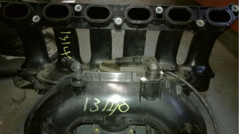

              I'm pretty sure my large DISA flap is shot, so I'm working on that, but luckily it's the easy one to swap so it's not critical path. I learned while doing this that there are two version of the 3-stage manifold. one of them has the single pcv port you can see in the center of the "big tube" above. The other has two ports which immediately Y together (discussion here: https://www.e90post.com/forums/showt...php?t=997384):
              Why are they different? who knows. I didn't track down which was earlier or later, or which models, had which one, but it's completely internal to the engine so it was some kind of design revision. If I had to guess I'd say having the port immediately opposite the throttle body caused vacuum issues for the PCV, and a single offset port wasn't ideal, but also didn't warrant a second heater (the difference between the big and small port is the larger one gets a heating element). I ended up with the Y hose in my order, but re-used my single hose. Maybe my intake wasn't original to the engine?

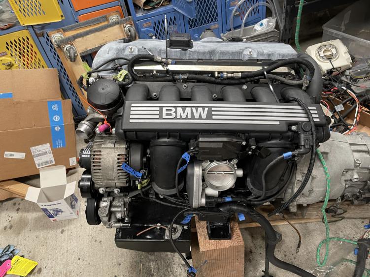

              My goal with Habla for the time being is to delay him as long as possible to probe him for detailed pictures of factory installations... he's already done me one favor by posting that underhood shot and reminding me that the wiring tray goes RIGHT over the middle of the engine. I was scratching my head last night trying to figure out how the factory routing worked behind the engine... and this morning I realized that it DIDN'T, which leaves me with that unsightly braid-covered PCV hose hanging over the top of the intake (it connects to the boot just in front of the butterfly valve. It's hidden under the cowl of the e90, but I'm going to have to find a replacement and snake it somewhere else.

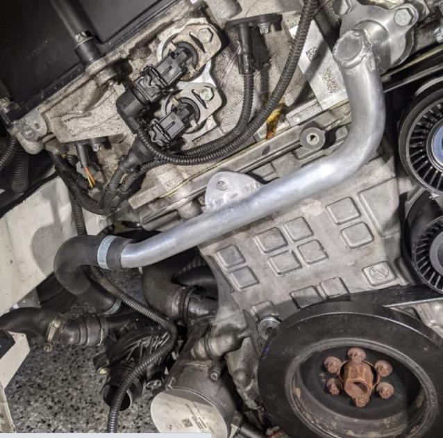

                          I thought I was going to be Mr. Awesome by mounting my hardline and putting the radiator back in with MILES of clearance, except the radiator outlet hose elbow wants to be right where my short, direct connection between the thermostat and the hardline is...
                          No amount of fiddling with different hoses worked, so I need to go back to the original thermostat with the different outlet, the original hose for the 330, and then cut the pipe outlet and rotate it 120 degrees, then it will clear fine.
                          I suppose that's still progress because now I know how NOT to do it...

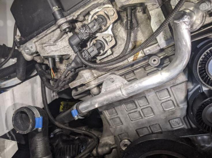

                                Rotated the outlet so it points down and back, clears the radiator outlet like a champ now.
                                Remember, the original rubber hose did clear and the hardline is NOT necessary for an N52 swap. It does make more room for a 50mm radiator and it looks better.
