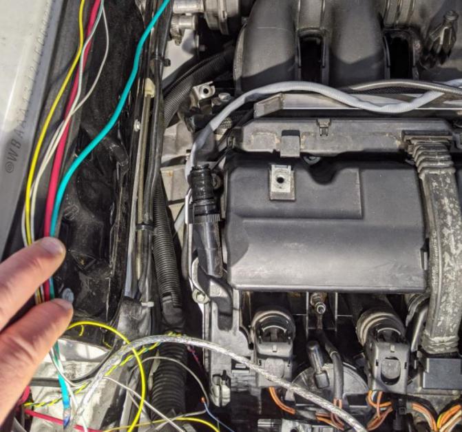

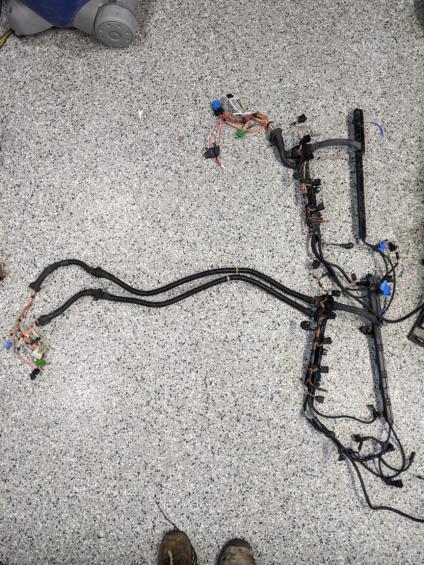

    Now that I have it running, I'll switch my E90 injector harness for an X3 one. E90 is incredibly short and won't reach the glovebox
    X3 could reach the passenger seat. Or the backseat
    E90 top, X3 bottom.
    The X3 uses a completely different style of alternator plug, the Valvetronic relay isn't incorporated and there are some other slight differences, but nothing major.

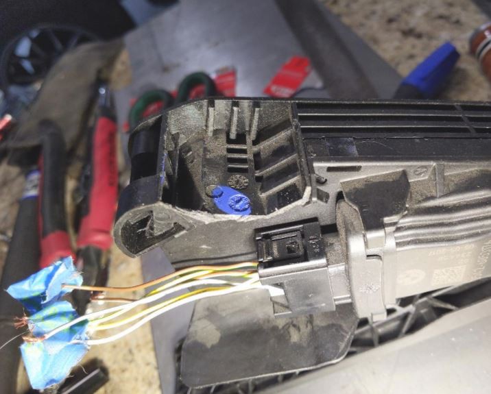

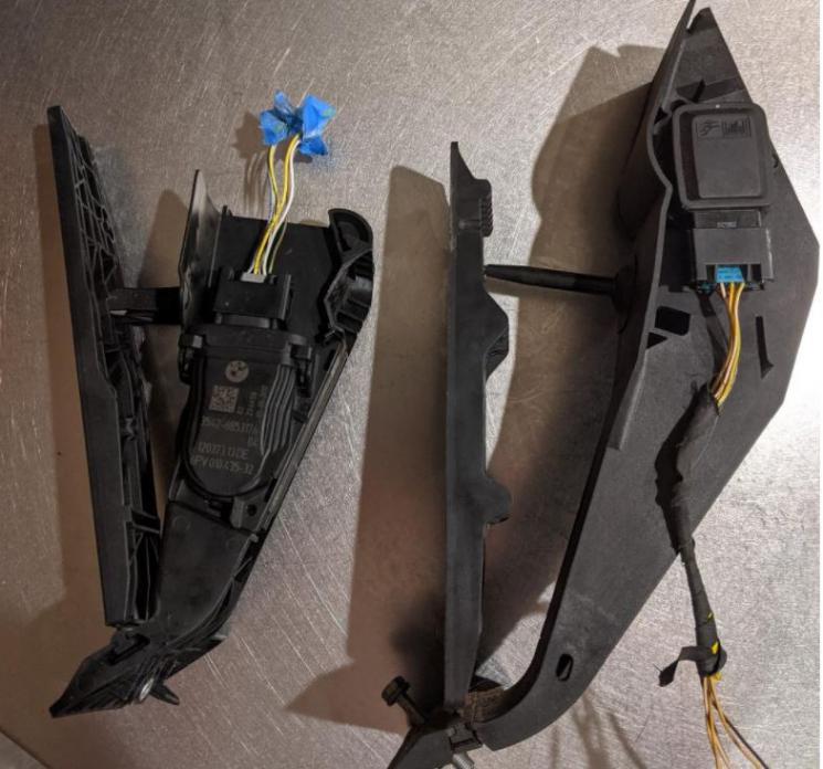

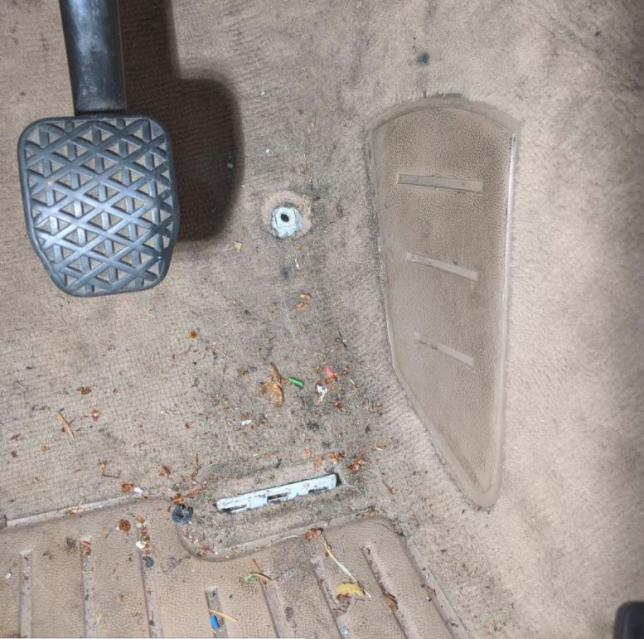

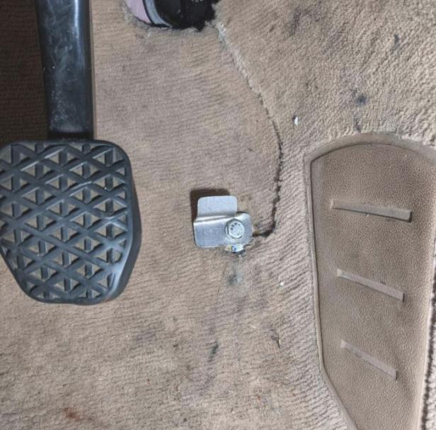

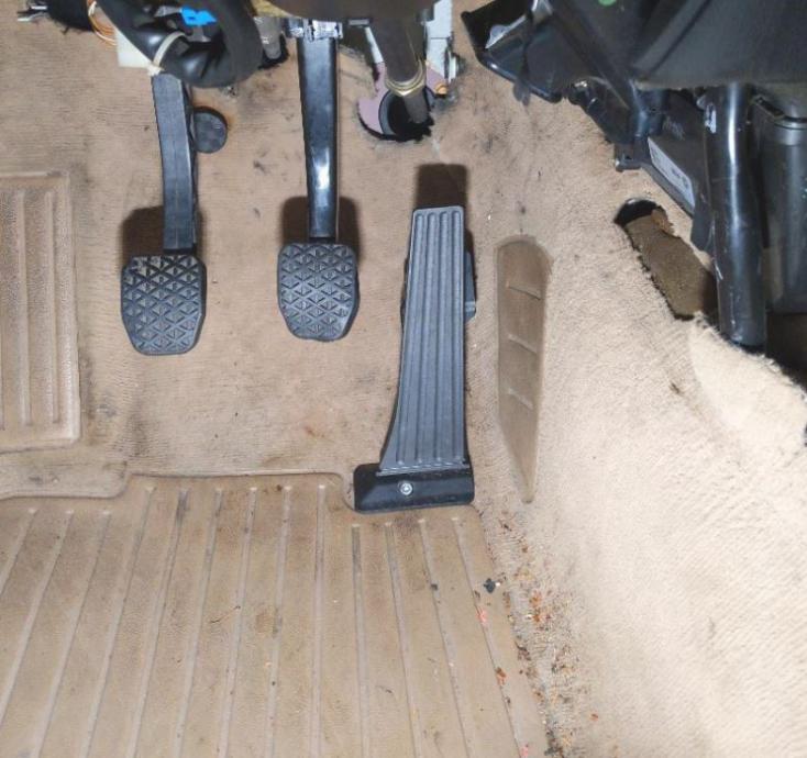

      Throttle pedal, done.
      I'm using the Z4 manual pedal which is considerably more svelte than an E90 pedal or anything else. The usual route is to use an E46 pedal and make a bracket and some epoxy, but I think this worked great.
      The pedal (P/N 35426853176) is meant to be mounted with an allen head bolt through the baseplate, so I welded an M6 nut in front of the e30 bracket for it.
      The rear has a cavity where a catch plate grabs the top of the pedal and secures it from lateral movement as well as rocking forward. Conveniently, the e30 bolt hole sits exactly in that pocket so it was a quick matter to fabricate a plate. It slides down onto the plate and is then bolted at the bottom.
      Rock solid!
      Click image for larger version  Name:	Capture4.JPG Views:	9 Size:	65.5 KB ID:	9968906
      Click image for larger version  Name:	Capture3.JPG Views:	9 Size:	85.1 KB ID:	9968905
      Click image for larger version  Name:	Capture2.JPG Views:	9 Size:	64.4 KB ID:	9968907
      Click image for larger version  Name:	Capture.JPG Views:	9 Size:	66.9 KB ID:	9968908
      Comparison of the two pedal styles. The Z4 style (left) is over 1/2 lbs lighter and the plunger is more robust. BOTH of them have the recess in the back for the catch tab. They work the same, but the plug is different between them.

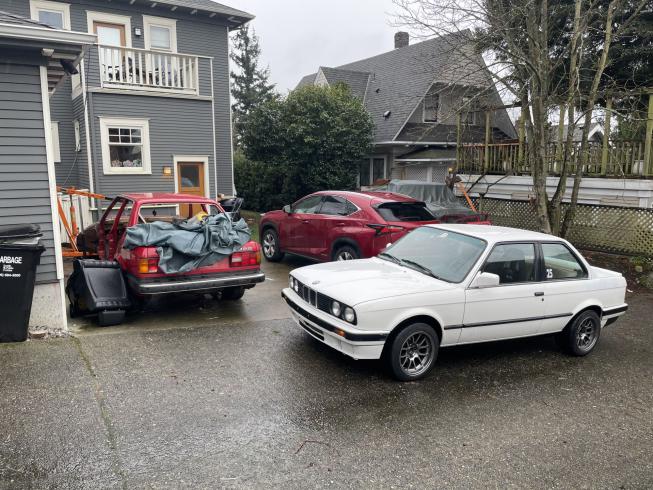

        Hey look what showed up at my house the other day tootin' it's own horn:
        • nando
          • 34839
          #439
          Nice! Also, does it have a lift kit? :p

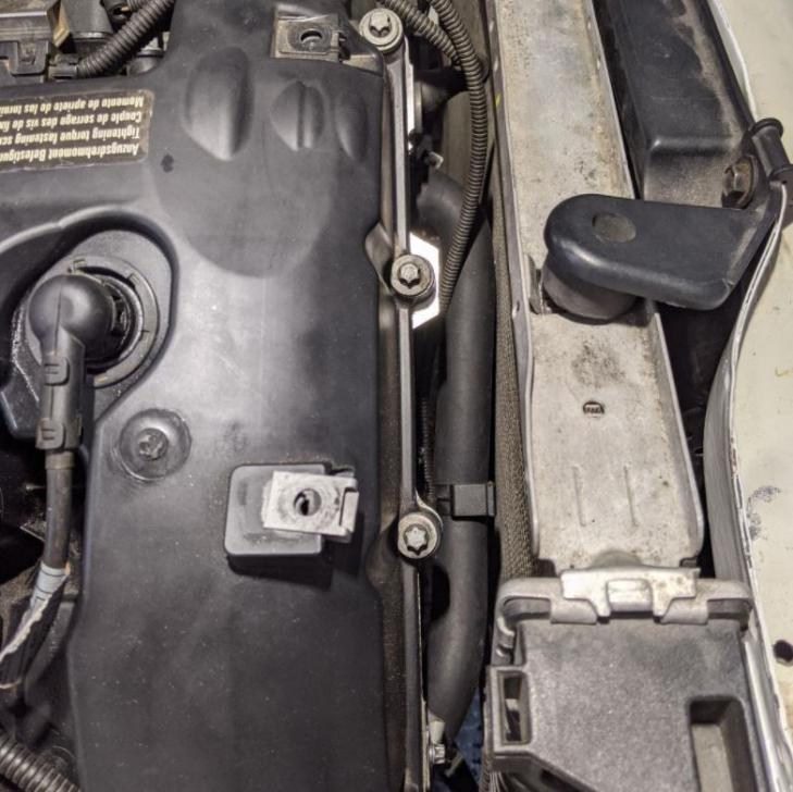

              Looks good, is it just the angle of the photo or is the engine very close to the radiator?
                I think the engine is identical in distance to the radiator as my M54 was, the issue with the N52 is that the coolant bypass hose runs in front of the engine and it gets within 8mm of the radiator. To the point where I'm not sure if I could run anything thicker than the OEM 33mm core in an all-aluminum radiator, for instance.
                Meanwhile, at the back of the engine there's miles of clearance...
                The positioning was predicated on the shifter being centered, naturally, and my shifter is maybe 5mm forward of the middle so there's future opportunity for the motor to slide back just a hair, probably 1cm.
                It looks much better from the bottom, where I have 2" clearance between the damper and the radiator core.

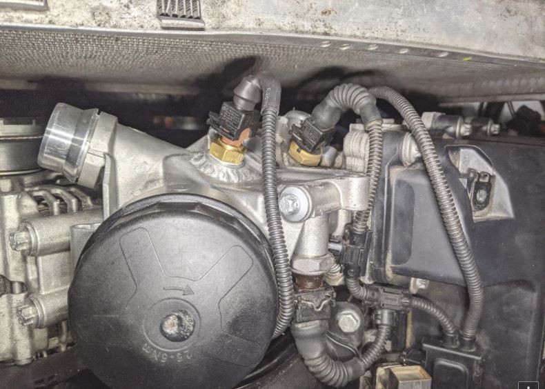

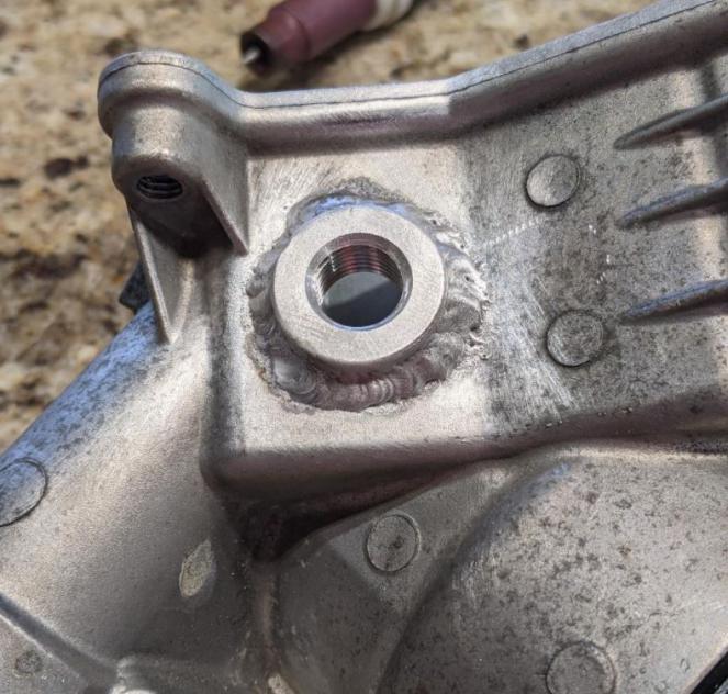

                                I haven't had the car driving for a week because after proving that it all works, I've taken some things apart to make improvements and move toward my "forever" configuration. Radiator and the front of the engine is the focus, starting with installing a modified oil filter housing with an M14 bung for the e30 cluster sensor.
                                The cross-under tube which was previously EMT is now professionally mandrel-bent 7/8" stainless.
                                You will also notice the clearance to the radiator, another goal is to fabricate a hardline for the coolant bypass hose that's normally close to the radiator and, finally, look at using an N54 serpentine tensioner.
