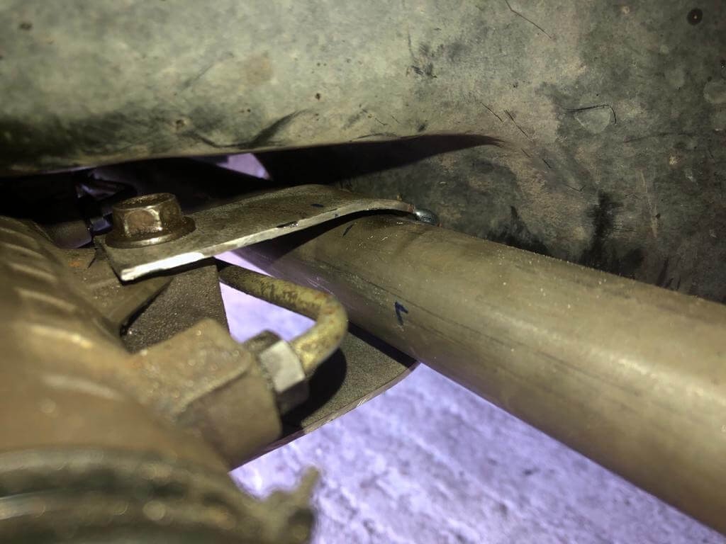

    Once the engine was positioned, the next step was to connect the driveshaft and mount the drivetrain. I used a Z4 N52 front prop and joined it to an E36 328i rear prop (same length as an auto M3 in the USA). Installed an early model E30 centre support bearing and the spline engagement was perfect - around 2 inches. After loosely connecting the propshaft to the transmission guibo and ensuring it was square, I modified the original M20 trans cross member to hold the new ZF GS6-37BZ. This consisted of re-drilling the holes for garagistic 80A mounts and welding in spacers to get the height perfect.
    For engine mounts, I used Z4 N52 mounts with garagistic 80A mounts. These placed the engine around an inch too far forward and I noted that cwlo addressed this by cutting and re-welding the Z4 mounts. Unfortunately, I don't have access to a tig welder and can't weld aluminium so instead opted to re-drill the mount locations. As I already modified the subframe it was easy enough to open up enough access for a nut on the underside.
    So at this point, the engine and trans were mounted in the car and the steering rack was in it's slightly new location. The steering column requires lengthening and I will need someone to tig this as it is made of aluminium. All steering lines fit perfectly with the existing e46 purple tag rack and the E90 steering pump so this was nice and simple. I still need to decide how to mount the E90 power steering cooler which should help with spirited driving/track work.

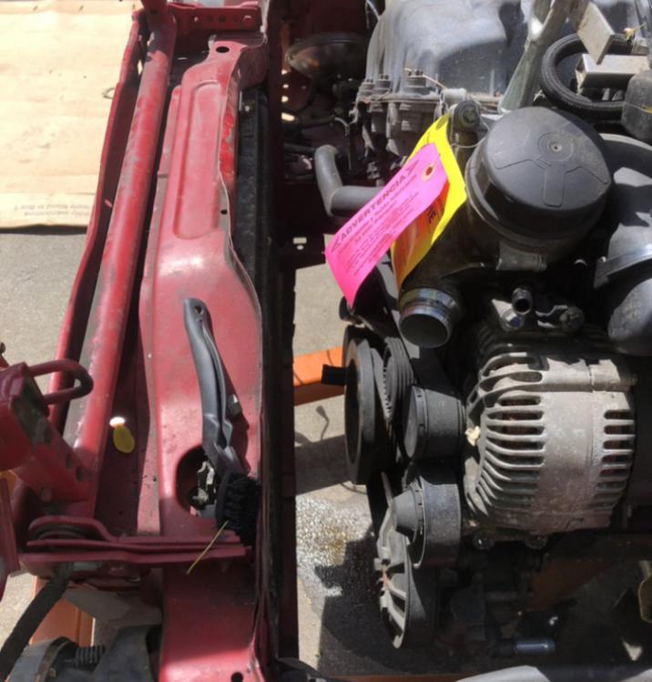

    Moving onto cooling, I managed to slide the E90 radiator into the E30 chassis after sanding down one of the plastic brackets. Clearance is tight but there is 5mm either side of the rad which will work. I welded L brackets to support it from the bottom and used to weld nuts to secure it up top. Once mounted, it was clear the original puller fan would not fit which was a shame but I managed to source two 10 inch fans rated at 1000cfm each. These are thin enough to be used as puller fans and were installed using custom mounts. Ideally, I'd like to retain the DME control of the cooling fans (controlled by PWM). I'm not 100% sure whether my solution will work but I found an E87 120d fan control module which takes the DME signal and outputs DC voltage. Hopefully this module can be wired to the aftermarket fans giving OEM function. Coolant hoses don't seem to be too difficult but I have yet to sort these. The most difficult appears to be the lower thermostat to radiator hose which is tight. As I am performing an AC compressor delete there is ample room for the thermostat to be relocated to provide extra space.
