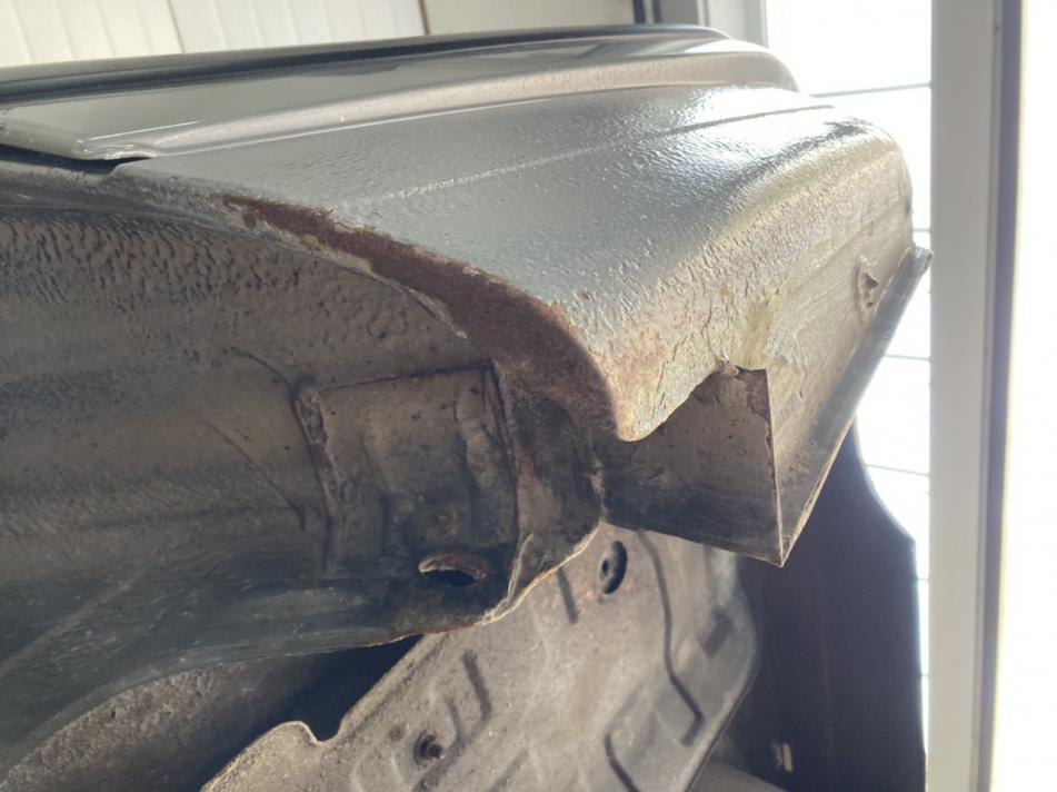

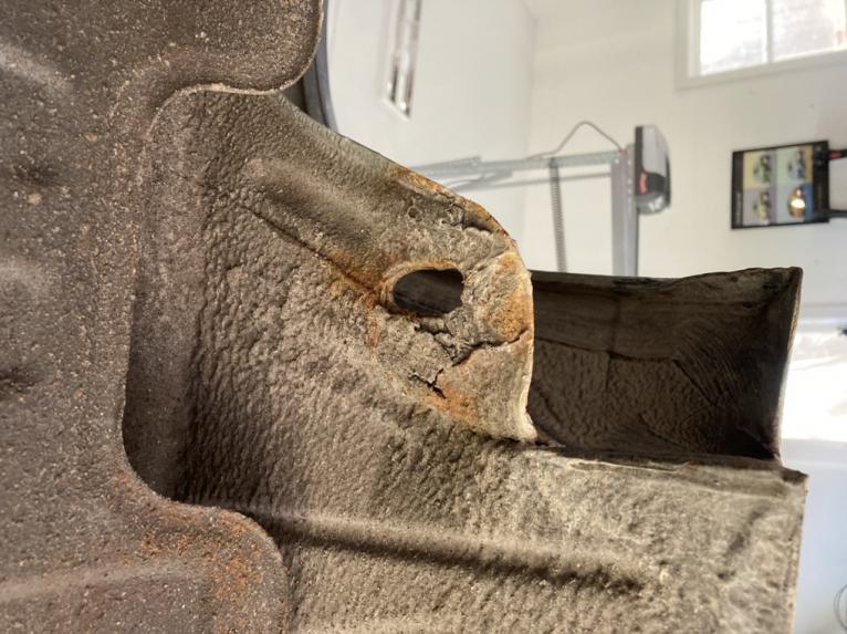

          Some pics of the rust

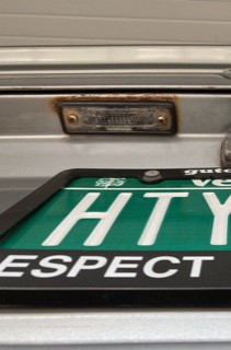

            That doesn’t look like it just started, but rather that its re exposing itself, esp battery tray and license plate lights.
              Something that was in the back of my mind as well.....car was recently repainted by the previous owner so who knows. Rest of the underside looks quite good so hopefully this is the extent of it.

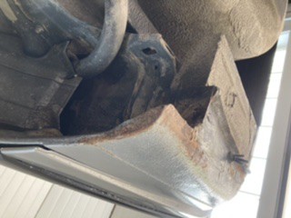

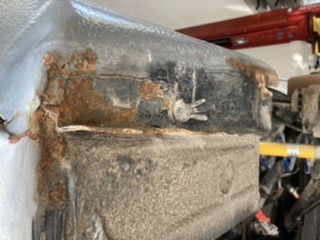

                Couple more pics....
                Last pic is my rusty black parts car parked next to the new to me ix.
