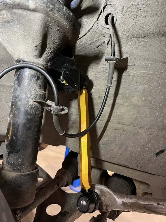

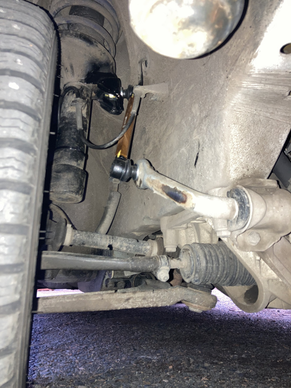

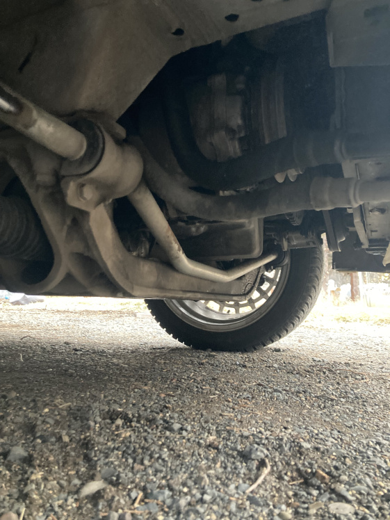

                It is possible! It ended up working with the Whiteline drop links, however, I ended up having new (much stronger) brackets custom fabricated because the old ones had been destroyed. It's possible it could be run without the reinforced brackets but I wouldn't recommend it, I have a feeling it would chew through them. It ended up very stiff, but the handling is amazing and noticeably improved, can really throw it into corners now. So there you have it, an ix with a 24mm bar, with a little creativity and $600 in fabrication work, it can be done. Pics are below. Thanks to Arcflash LLC in Bend, OR for the fabrication and installation.
